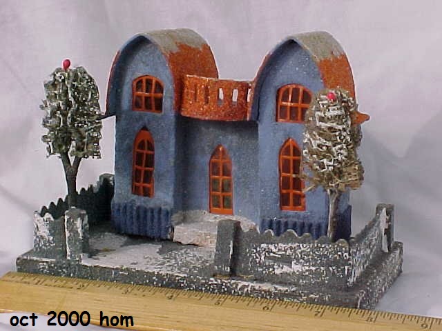

You'll also find a picture of the vintage original in the post immediately after the patterns...

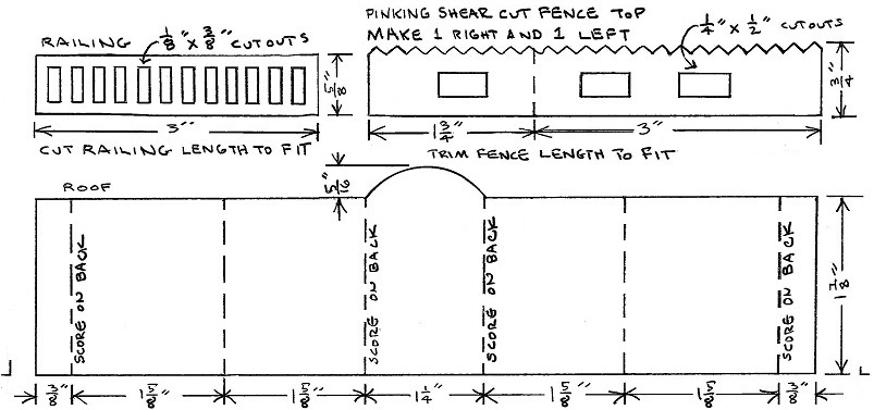

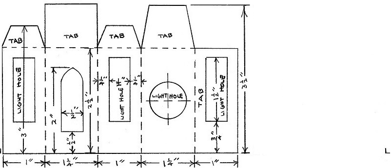

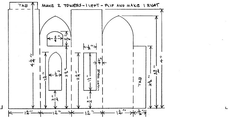

Patterns are below…photos of the construction will follow...

here's a small photo of the vintage original...

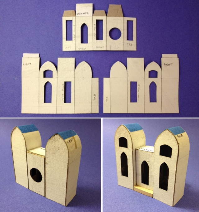

starting to take shape...the blue painter's tape is just temporary to hold the roof peak glue joint in place until the glue dries...the step is 1/4" x 1/4" craft wood cut to fit between the towers...more pictures later...

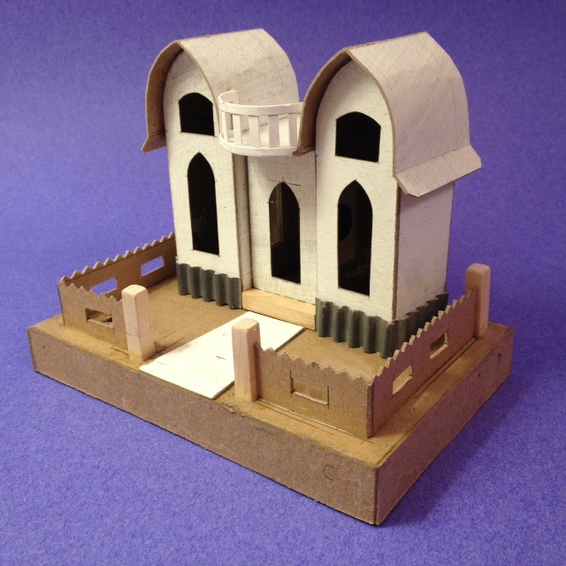

house, base and fence assembled...working on trees and windows...more later...

Beautiful. Great choice of a house as well. Was it hard to glue down those curved roofs? Did you use your "third hand" device to glue them down? I really like the way you did the under roof. I'm sure that add much more support. Thank you for showing the process. Lucy

Lucy wrote:Beautiful. Great choice of a house as well. Was it hard to glue down those curved roofs? Did you use your "third hand" device to glue them down? I really like the way you did the under roof. I'm sure that add much more support. Thank you for showing the process. Lucy
gluing the roof in place was done in steps after i made sure the scores were in the right places...the center roof (with the curved porch projection) was glued in place first and allowed to dry...then i did one section of roof at a time and let dry thoroughly before going on to the next...it helps to pre-curve the roof sections by rolling them over a round object first...(i used a prescription bottle)...i didn't use the "third hand" thing this time...but i do use a lot of blue painter's tape to hold things while they dry...i hope this helps...howard...
