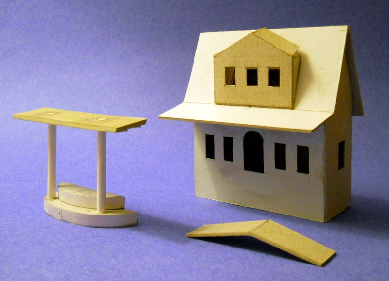

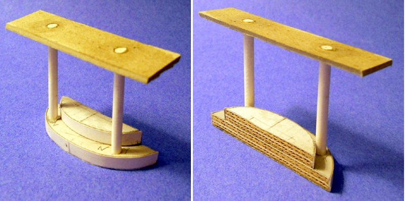

I built the house and attached the roof first...then made the porch...the key is making sure the post holes line up...and giving the top a slight pitch to the front...just an 1/8" or so...
The first picture is of the original house...the “little glitter house” pictures are next…patterns for the pieces will be posted shortly…
o2-2002-hom-lgh-version 002-001.JPG (127.3 KiB) Viewed 27814 times
o2-2002-hom-lgh-version 004-001.JPG (134.01 KiB) Viewed 27814 times

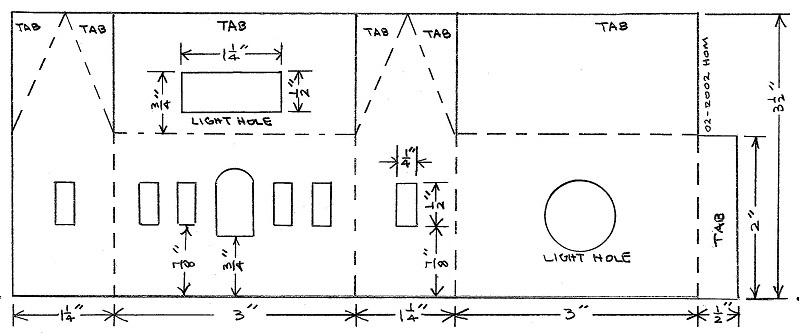

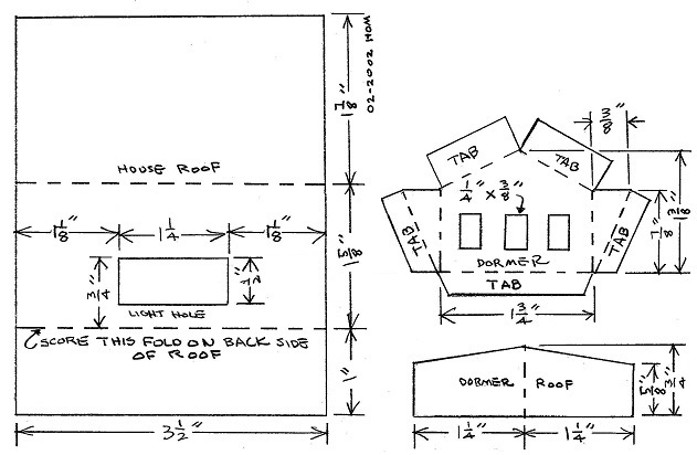

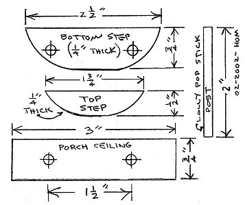

Patterns for pieces...more pictures of the project will follow next week...

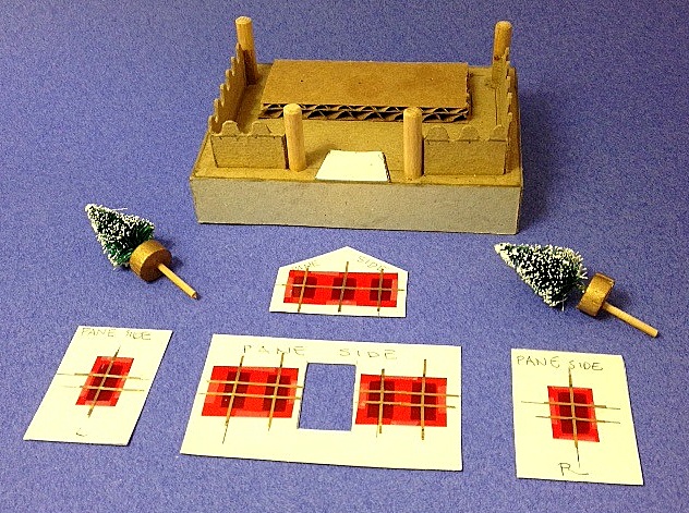

good afternoon...
here are the other parts of the project with the exception of the paper door...having a few new doors printed very soon... :D
the toothpicks sticking out the bottom of the trees will be glued into holes in the base...
going to use about the same house and base colors as the original...and finish off with mica flakes and glitter...

This is a lovely re-creation of the Feb. 2002 house of the month. The curved stairs are beautiful. Thank you for showing us how you made the steps.

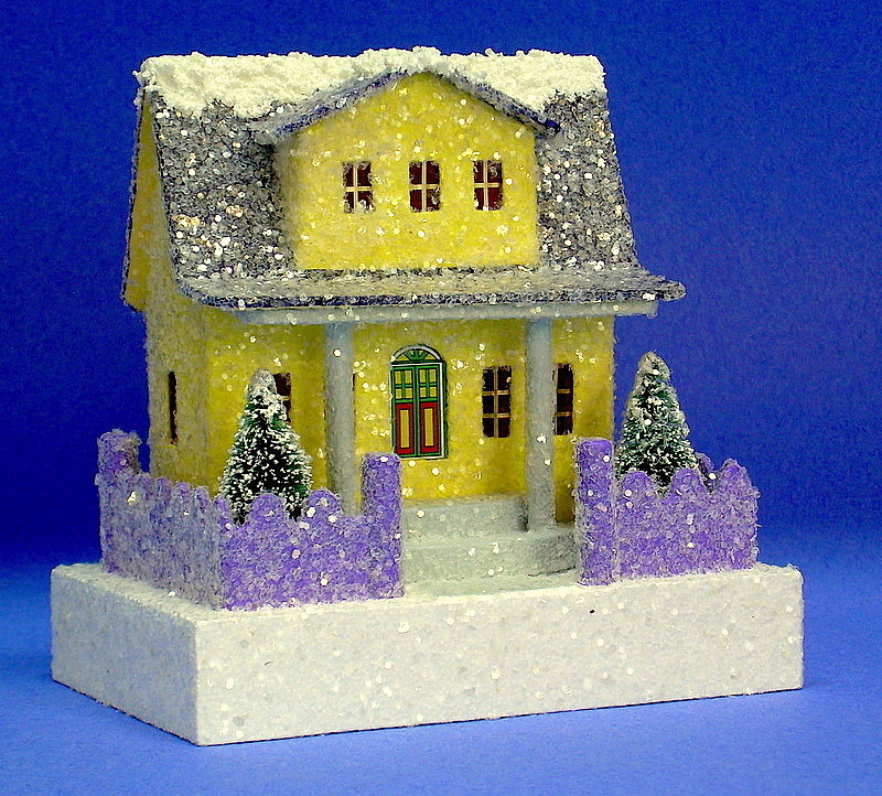

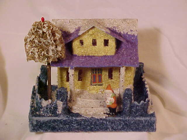

good morning...
here is the finished house...i'll let the picture speak for itself...the body may appear to have a green cast to it...but it doesn't...it is actually a bright yellow...i'm pretty sure it's due to the "shared" light reflection from the blue background...and the florescent lighting in my shop...
house 001-002 (2).JPG (277.32 KiB) Viewed 27820 times
