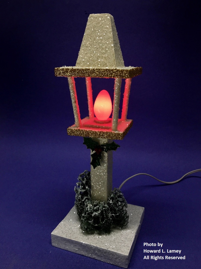

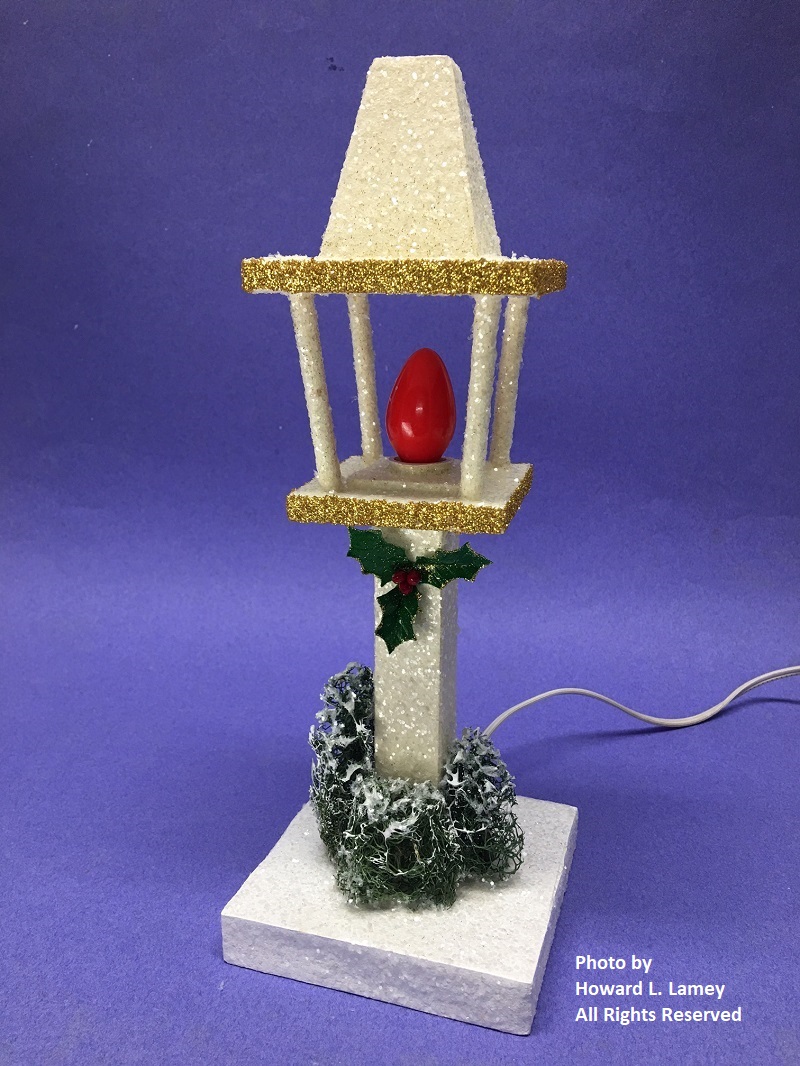

Here's yet another project that has been on my "to do list" for a long, long time...I know it's not a house...but the originals were mostly cardboard and were made in Japan so I think it qualifies as being putz related...
I'll be posting work in progress photos, construction details and patterns in the near future...stay tuned...
2023 PROJECT NO. 2 -- ILLUMINATED LAMPPOST...
- Approximately 11" tall...

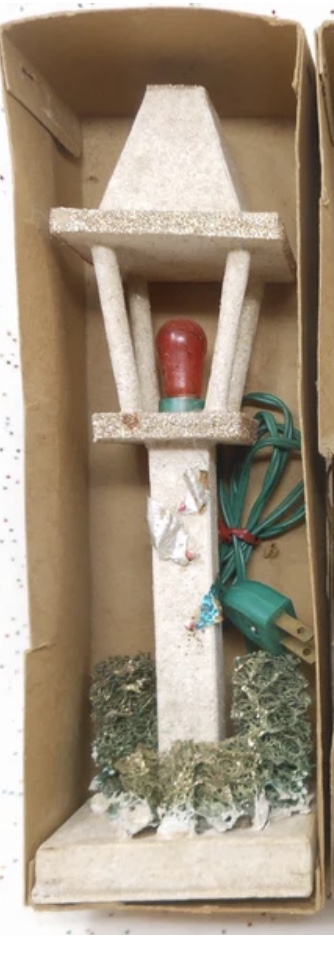

- One of the vintage originals I used for reference and basic dimensions...
- IMG_0847.jpg (91.29 KiB) Viewed 12293 times

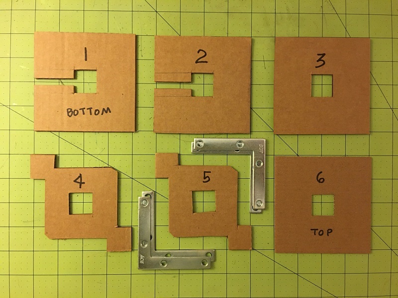

BASE…4” square x 3/4” thick laminated corrugated cardboard edge banded with thin cardboard…four 3” flat metal corner braces for weight and stability…NOTE…the square holes should be cut to be a snug fit for the column…I’ll add a layer of felt to the bottom when the project is finished…

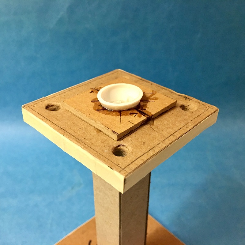

ILLUMINATION…an “all-in-one nightlight socket set“…wall plug, cord, on/off switch and socket…no electrical skills required…but the metal spring clip on the socket has to be removed…I used needle nose pliers and twisted the narrowest part of the clip back and forth until it broke…
SOCKET HOLDER…a square of thick cardboard that has been hole punched, cut in half and trimmed to fit snugly around the socket…super glue was used for assembly of these parts and attaching it to the top of the column…NOTE…the socket and cord must be installed up through the bottom of the column and glued in place before making the four uprights and adding the top and flat top spire cap…I’ll wrap the cord, switch and plug in a plastic bag during application of the finish…
FINISH AND TRIM DETAILS…I basically followed what was on the vintage original…light antique white/ivory paint with clear glitter…gold glitter on the edges of the light cage top and bottom…miniature holly leaves with berries I found at Hobby Lobby and some pieces of luffla sponge…

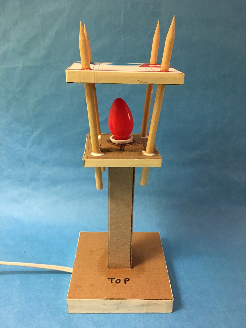

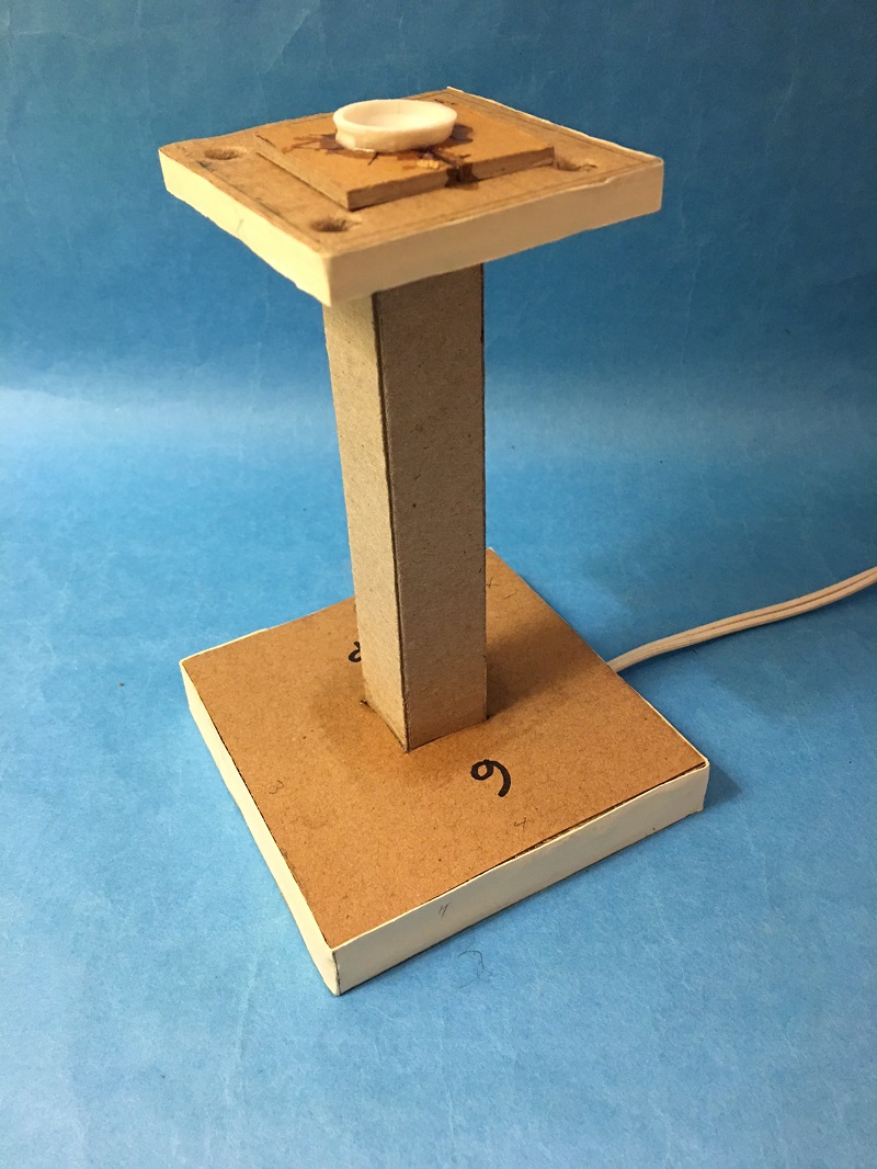

CONSTRUCTION PHOTOS...
Additional photos will follow this first set of three...
- lamppost bae pieces.jpg (162.71 KiB) Viewed 12196 times
- lamppost base.JPG (207.92 KiB) Viewed 12196 times
- lamppost socket.jpg (156.61 KiB) Viewed 12196 times

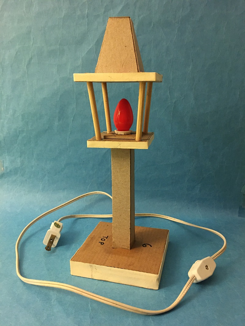

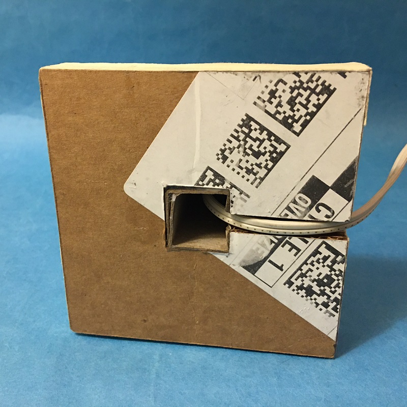

Re: 2023 PROJECT NO. 2 -- ILLUMINATED LAMPPOST...
Final set of three...
- lamppost cage lollipos sticks.JPG (211.91 KiB) Viewed 12196 times
- lamppost column.JPG (243.17 KiB) Viewed 12196 times
- lamppost raw cardboard.JPG (251.43 KiB) Viewed 12196 times
