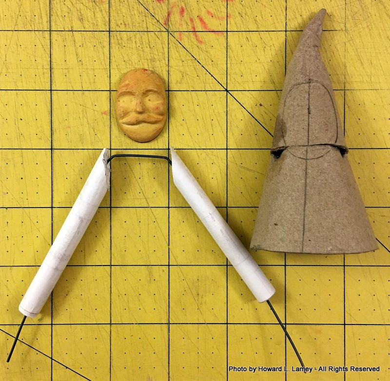

BODY…cereal box cardboard cone…4” tall x 1 5/8” diameter at base…slit for arms armature, that cuts body almost in half, is 2 1/2” down from tip…later, the base is gently squeezed into more of an oval…note…after the cone was totally dry, the top cap portion was crumpled and gently folded over to one side a little…I found it useful to slightly dampen the area to be folded…and was surprised at how easily it molded and stayed crumpled after drying…
ARMS…rolled paper tubes 3” long x 5/16” in diameter on soft wire armature…cut at an angle at the shoulders…trim to appropriate length, bend at the elbows and pose after securely gluing to body…
FACE…I bought a Santa face push mold several years ago…then cast one with water putty and carved away the cap, beard and any details I didn’t want until I had a generic face…after making a modeling clay push mold, I cast several with Dunham's water putty...go here...http://www.waterputty.com/creative.html

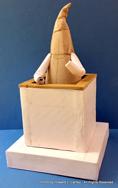

3” SQUARE CHIMNEY…made from triple thick corrugated cardboard…top of chimney is recessed 3/8” down on inside from top edge…outside covered with layer of copy paper and cardboard strips added to top edge of corrugated sides to cover exposed flutes…note…the chimney could be made with a candy box cavity…or you could use a ready made paper mache craft store box…I seem to remember that forum member, Lucy, has used empty cardboard ribbon spools on some of her projects…
BRICK PRINTED GRAPHICS…I found the one I used on the internet eons ago…you’ll see it when I post pictures of the finished piece later on…the internet is full of printable brick images…do some searching…I’m sure you’ll find one you like…Paul also has several brick patterns available…go here and scroll down to “Building Textures“…
https://bigindoortrains.com/indoor_reso ... ources.htm
Note…you may want to resize the images if the bricks look too small…
SNOW WRAP ON CHIMNEY…white cotton batting…glued to brick paper covering…folded over top edge and down inside to top of chimney box…highlighted with random glitter accents…
BASE…4” square x ¾” thick putz house style base…

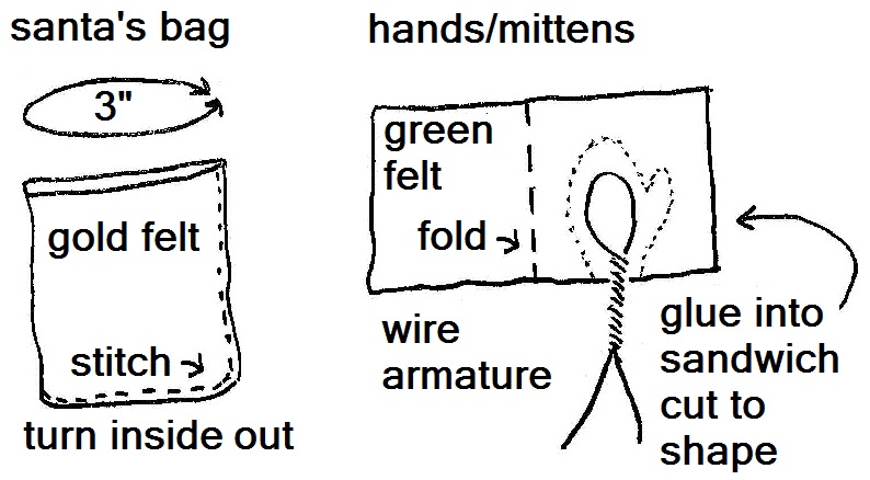

HANDS WITH MITTENS…a sandwich of a double layer of green felt with soft wire armature glued between layers…let dry thoroughly and cut to shape…see sketch…

BAG…2” x 3” rectangle of gold felt…fold in half, sew and turn inside out…stuff with tissue paper…cinch with fine wire…drawstring is length of burlap string…
santa in chimney face arms body.JPG (201.12 KiB) Viewed 41055 times
santa in chimney body chimney.jpg (141.76 KiB) Viewed 41055 times
santa in chimney body base chimney bag face.JPG (174.51 KiB) Viewed 41055 times

A quick picture of the way the major parts look when temporarily assembled...the arms have been posed...but the final assembly and glue up with all the detail parts won't be done after all the parts are finished...also a detail of how Santa's bag and mittens were made...

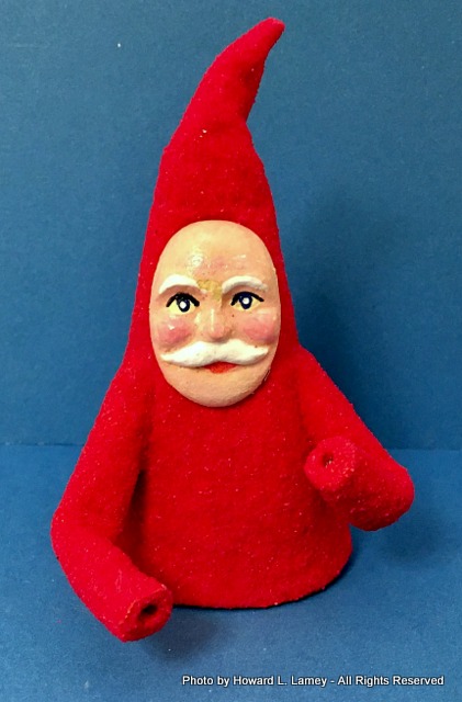

Here's the body after a couple of coats of primer, two coats of red craft paint and a carefully applied finish coat of fine grain red craft sand...Gorilla(R) Super Glue was used to attach the face...

So cool. I love how you construct your figures. And you are always modifying and improving techniques.

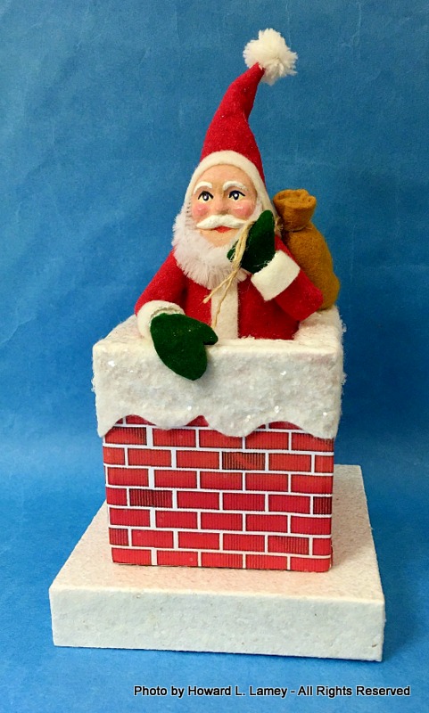

Another project is finished... :D
My very best regards...

This is just marvelous Howard!
Re: SANTA IN A CHIMNEY...a decorative classic...
What a vintage delight this is!!
Thank you, Howard.
