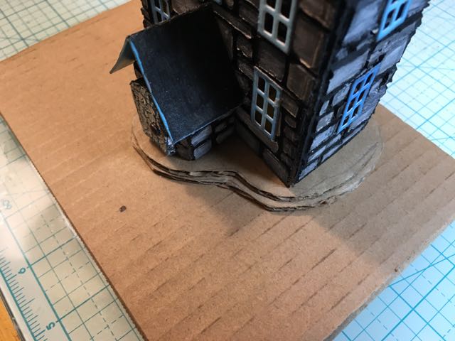

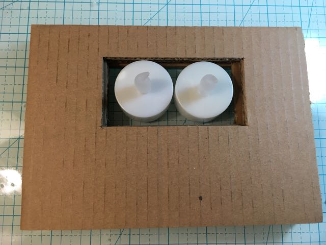

Lately, I've been making bases to fit LED tea lights. I cut a rectangle big enough to fit 2-3 LED tea lights through several layers of corrugated cardboard, glue them together, cover with paper, then gesso and paint. If my house is too small for the diameter of the tea lights, I make one layer with a smaller opening to support the house, but allow the tea light "flame" to peak through. I have a few photos.
I just thought people might be interested in this technique because it lights up the houses so well.

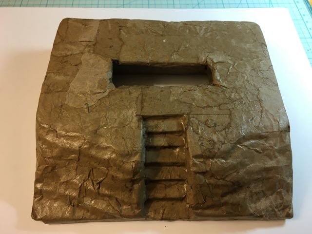

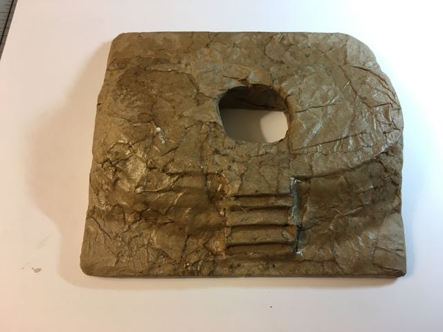

Re: Base for LED tea lights - stairways
Two new bases for the next houses. I've planned on doing stairs for awhile, but I never planned enough when I was making the base to include them. For these bases I made the stairway an integral part of the base. I will paint them later when I decide on the color scheme for the houses. I'm hoping they will look pretty cool.
Wow Lucy, nice! Paper mache?

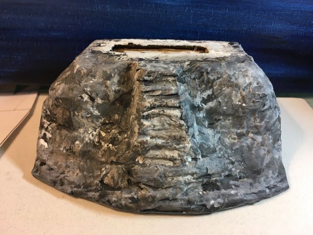

Yes, paper mache. I save the brown paper from packages I receive. I tear it in little pieces, wrinkle it and glue it down with mod podge. When I paint it, the shiny surface is covered up. Here is one of the bases with a white gesso base, a black gesso wash and a little ochre. It's starting to look like stone.

Here is the latest base for LED lights. The base is called Slippery Slope which is what this halloween house will be called as well.
I haven't finished the painting. I always play around with the paint to make it look like a rock outcropping. At some point, I will quit adding paint and call it done. It's kind of fun to paint this way.
