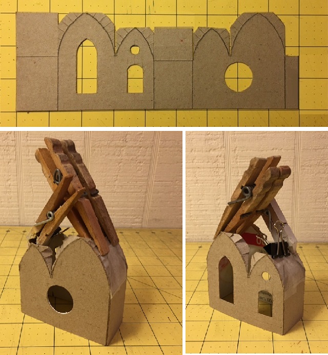

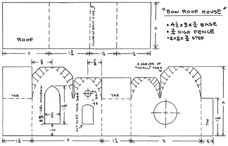

I’ll let the pattern sheet and photos tell the story...other than to mention a couple of things...
Pre-bend the “bow” in each roof section before trying to glue it to the house body…I pre-bent mine by wrapping around a bloom handle…
In addition to clothespins and paper clamps, I used gift wrap tape to temporally hold the multiple little glue tabs on the edge of the body in place while the glue dried…the tape was removed before attaching the roof…

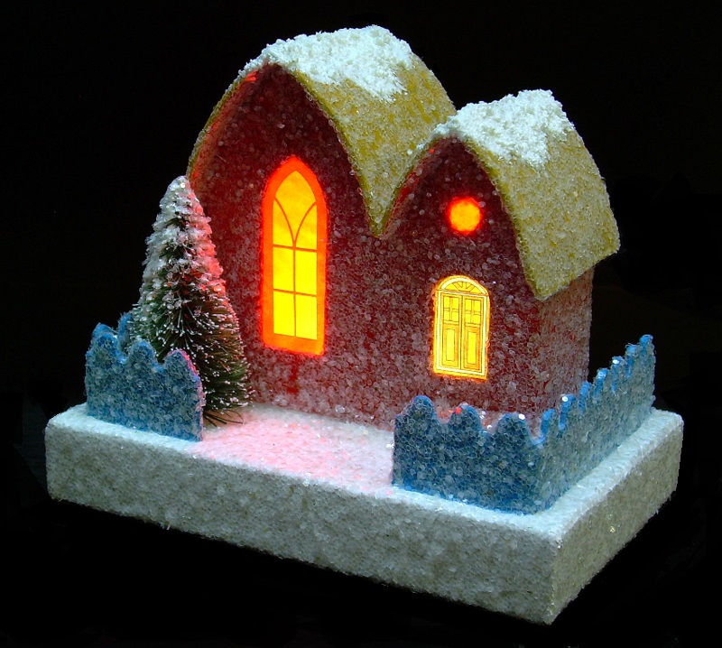

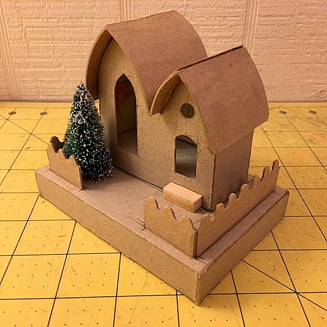

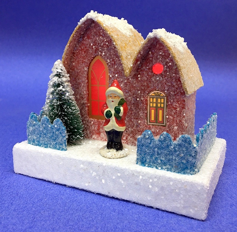

These last thee photos complete the story on this project...
bow-roof-house-primer-ready (2).JPG (178.31 KiB) Viewed 22831 times
bow house finished iphone pix.JPG (295.61 KiB) Viewed 22831 times
bow-roof-house-finished 005-001.JPG (202.89 KiB) Viewed 22831 times

Looks AWESOME Howard!!! :) It's fun to see them lit up at the end too!!
