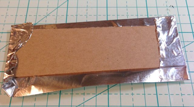

1. Cover the cardboard with foil tape. You can get this tape easily at a hardware store or one of the home improvement stores. It is not the flexible duck tape, it is true foil-covered "duct" tape to help seal ducts. I found it in the tape section at Lowes I think.

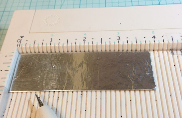

2. Then score the taped cardboard to look like the ridges on a sheet metal roof.
1 Covered cardboard cc.jpg (44.6 KiB) Viewed 27989 times
3 Scoreboard foil cardboard cc.jpg (39.64 KiB) Viewed 27989 times

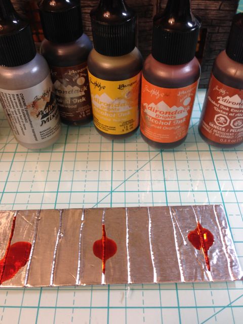

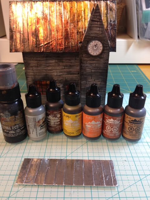

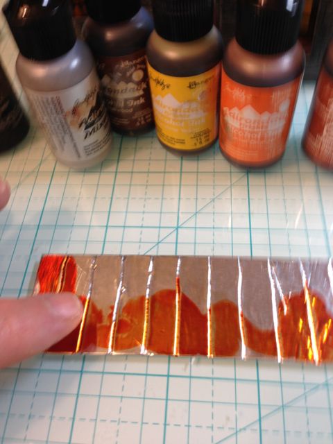

Now you have the scored cardboard with the alcohol inks lined up behind them.
Drop some of the alcohol ink on the foil-covered cardboard and smear around.
5 Alcohol inks for rusted roof cc.jpg (70.96 KiB) Viewed 27988 times
6 Drop alcohol inks on foil cc.jpg (61.16 KiB) Viewed 27988 times
7 smear with finger cc.jpg (49.76 KiB) Viewed 27988 times

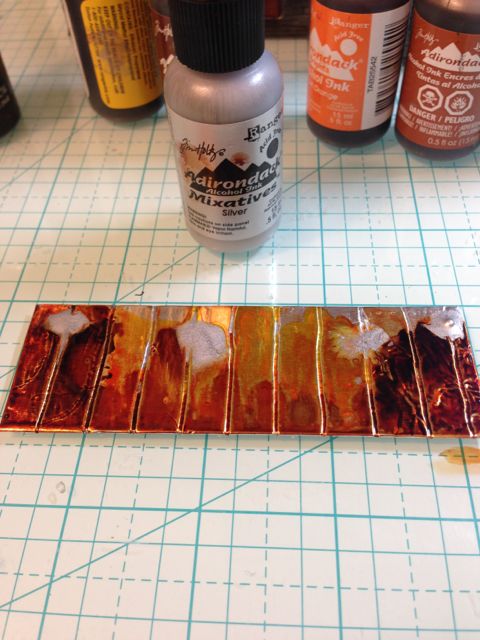

Re: Rusted Tin Roof tutorial

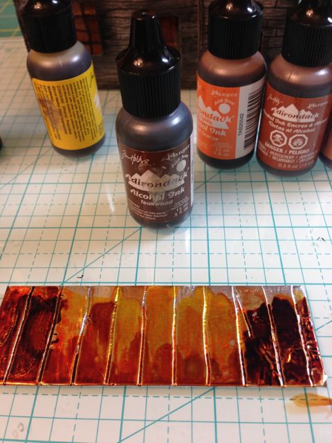

Continue to smear the ink around with your finger. I used progressively darker inks as I went along. I really think 3 colors is probably sufficient - a gold, orange, and brown.
8 smear 1st layer of ink cc.jpg (61.17 KiB) Viewed 27988 times
9 add diff alcohol ink colors cc.jpg (63.69 KiB) Viewed 27988 times
10 add progressively darker inks cc.jpg (64.86 KiB) Viewed 27988 times

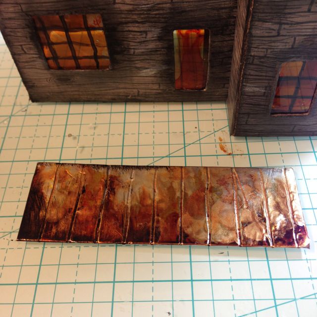

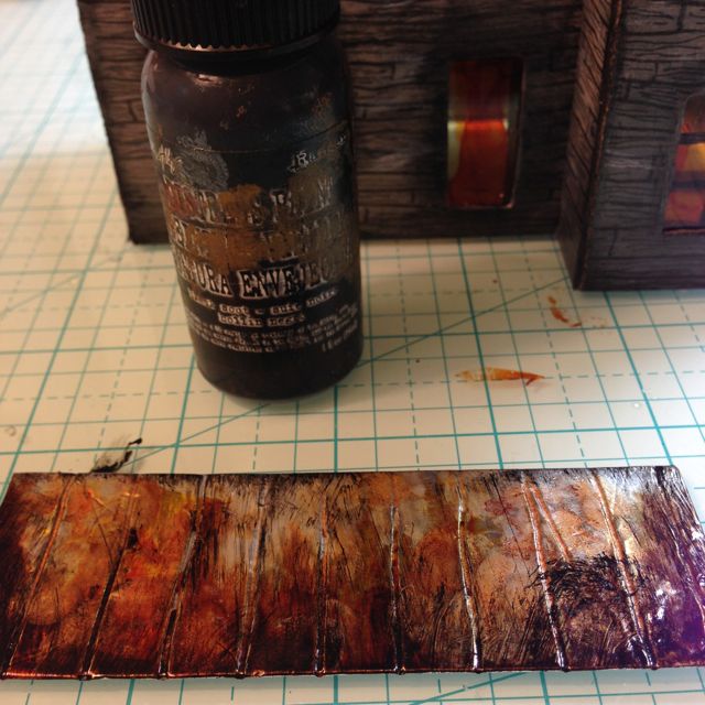

I added something called "Silver mixative" which seemed to make everything meld together nicely, but truly I don't know what it is supposed to be used for.
Smear everything together again.
Then I used some acrylic distress paint (probably any acrylic paint would do) and painted the edges darker to complete the aged look.
And that's it. It's a really easy roof to do. Much easier than cutting shingles like I did for some of my other houses.
11 silver alcohol mixative cc.jpg (63.48 KiB) Viewed 27988 times
12 smear everything around cc.jpg (75.13 KiB) Viewed 27988 times
13 distress ink at bottom cc.jpg (77.26 KiB) Viewed 27988 times
