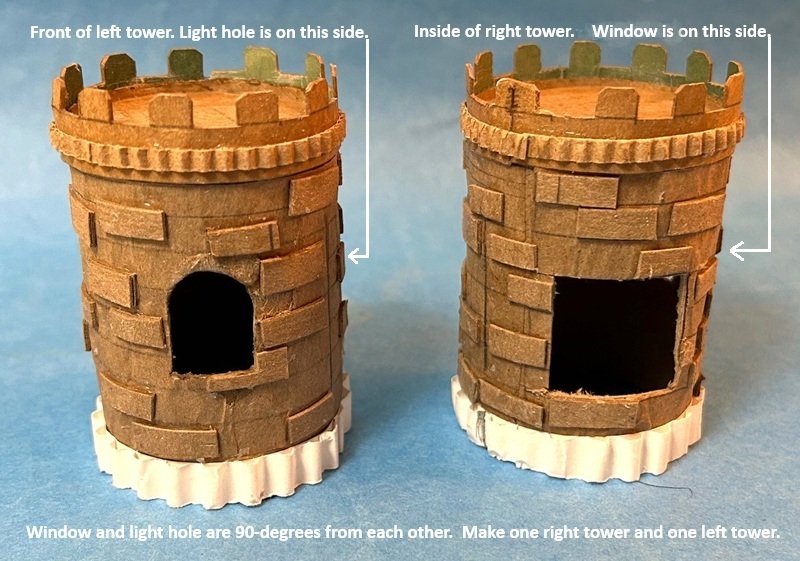

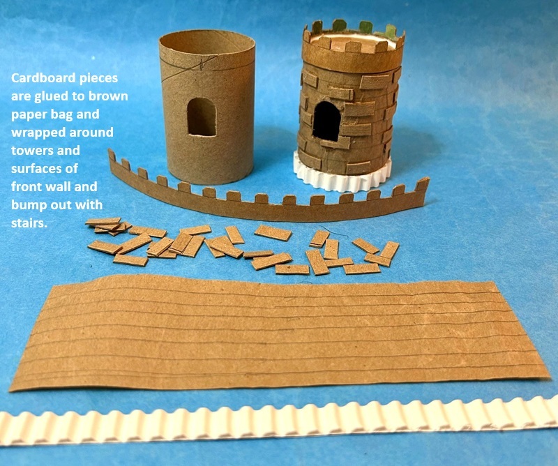

Unlike the original, my version is constructed from cardboard rather than being cast. To simulate the appearance of individual stones, I cut separate pieces of cardboard and glued them onto brown paper. This brown paper is then used to cover the towers, the front wall to the left of the stairs, as well as the front and right side of the bump-out section.
Structure Overview

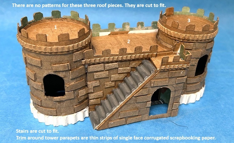

The main structure consists of two cardboard tubes connected by a central section. Additional features include a bump-out with stairs and a sturdy base.

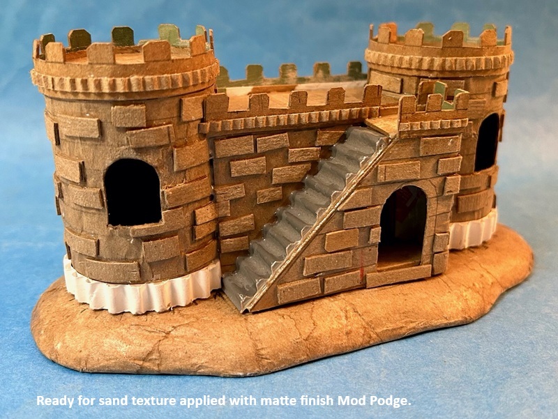

Surface Texture and Painting Techniques
For a realistic, textured finish, I applied sand using matte Mod Podge. After priming and painting the structure, I added detail by painting selected bricks in various stone colors. Areas were further highlighted using the dry brushing technique. If you are unfamiliar with this faux painting method, I recommend searching for online tutorials to help you achieve similar effects.

The pattern sheets, available in the PDFs below the work-in-progress photos, provide templates for the major components of the castle. Detailed construction notes are also included on the pattern sheets. Please note that not every piece is represented on the pattern sheets; only the primary elements are included. Trim and other parts will have to be measured, cut out, and trimmed to fit during assembly.

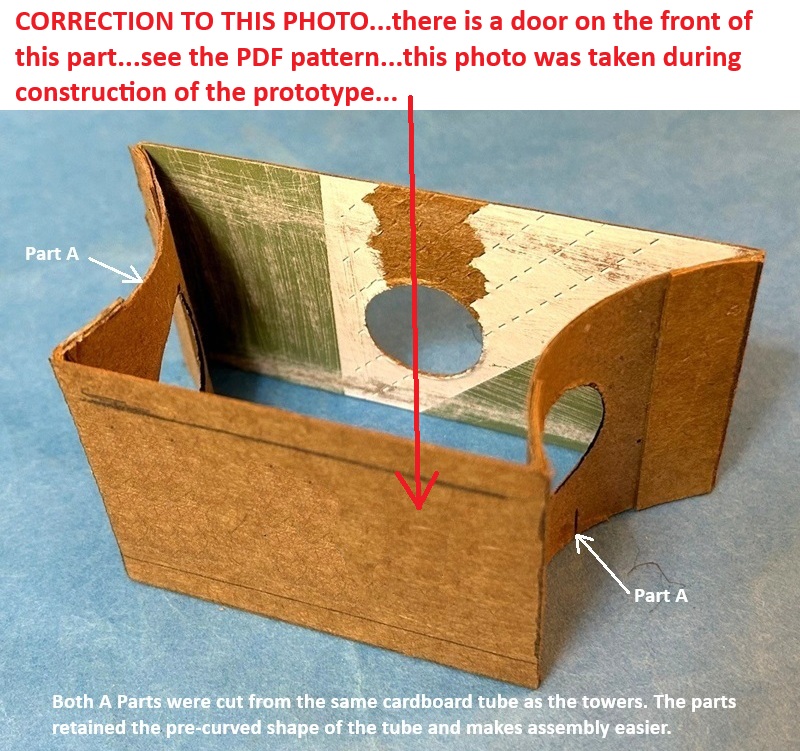

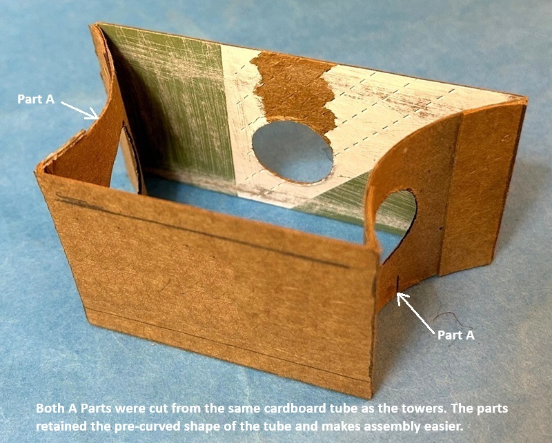

center part.jpeg (205 KiB) Viewed 48140 times

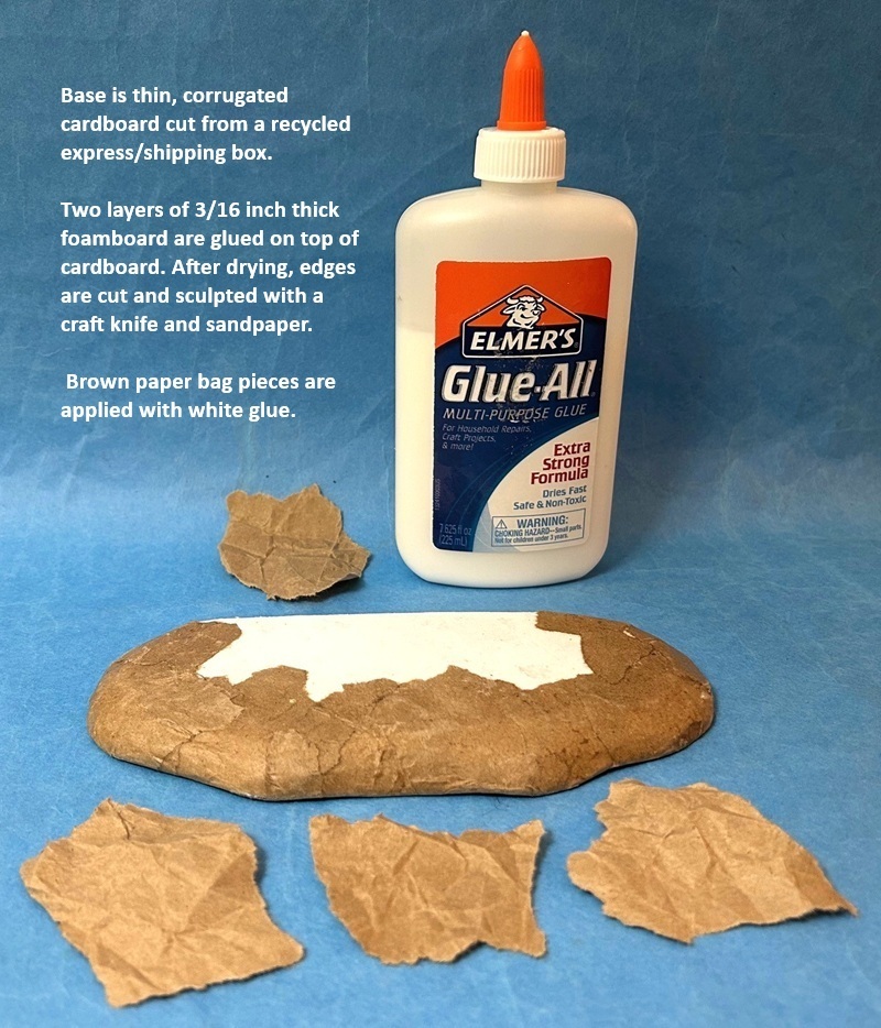

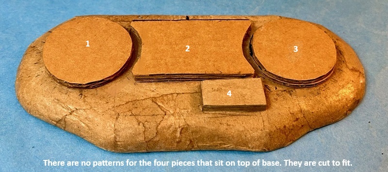

base work in progress.jpeg (266.74 KiB) Viewed 48140 times
base finished with foundations.jpeg (163.28 KiB) Viewed 48140 times
tower parts.jpeg (195.01 KiB) Viewed 48136 times
Re: 2026 Project No. 3 — Twin Tower Castle
UPDATE 2/22/2026
See the updated photo below.
center part.jpeg (249.98 KiB) Viewed 47574 times

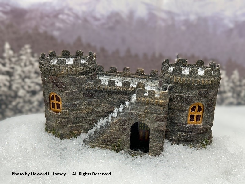

Greetings to all,

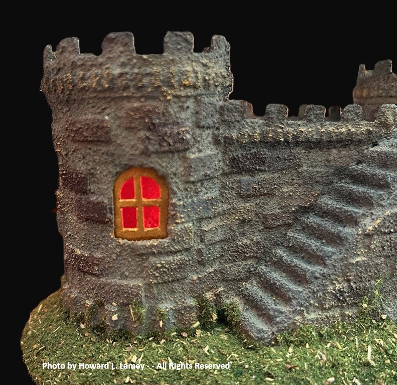

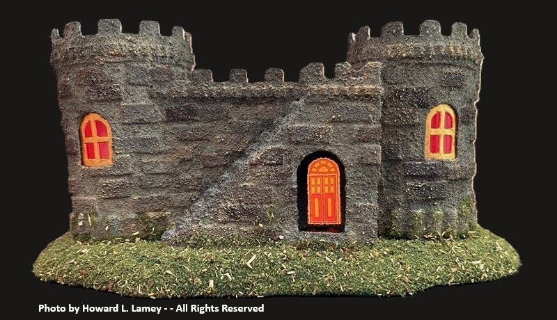

Here are three photos of the finished castle. Please note that lighting differences (the Kelvin Scale--and too nerdy to go into here) affect the color appearance; the snowy scene intentionally looks wintry. The green ground cover is a blend of dried leaves, sawdust, straw, and model railroad grass turf, run through a blender, sifted and applied with white glue. The photos highlight the sand texture, dry brush effects, and gold paint accents. The window mullions are hand cut from cardstock, painted gold and backed with red acetate.
Stay creative and stay tuned for more Little Glitter House projects.
1 illuminated tower.jpeg (284.24 KiB) Viewed 43583 times
1 illuminated castle.jpeg (170.06 KiB) Viewed 43583 times
1 castle in snow.jpg (168.03 KiB) Viewed 43583 times
