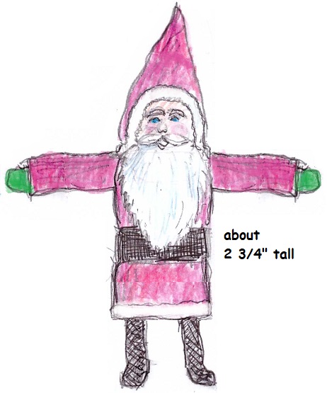

Before I start posting my first Candy Box Santa project, let me say “Thanks“. I am indebted to several of my long-time Cardboard Christmas Forum e-friends for their input, help and support. I used all their knowledge to make my own version of the quaint little figures. I also want to thank to Paul for setting up this new sub-category on the forum...
See the concept sketch of my Candy Box Santa below...

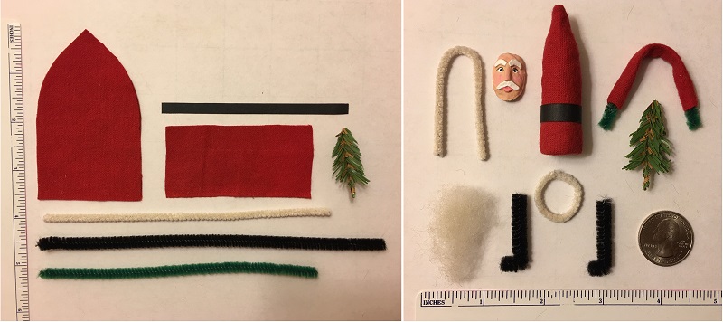

MAKING A CANDY BOX SANTA FIGURINE

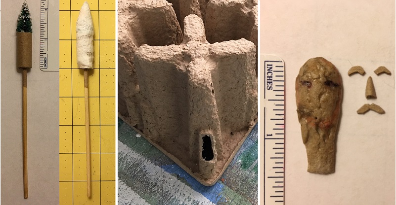

Body Form -- Strips of paper rolled and glued around a bamboo skewer…drill hole in top for small bottle brush tree trunk and glue in place…wrap body form with strip of paper towel and glue like paper mache…finished body form is about 2 1/4” long x 1/2” diameter…leave skewer long for a handle while building…cut skewer flush with body when ready to add legs…
Note -- I used Aleene’s Original Tacky Glue® and Elmer’s® Glue-All on throughout this project…
Suit -- Red flannel folded and stitched…turn inside out to form pointed tube…the fit over body form should not be skin tight…turn up suit bottom edge about 1/2” to make a cuff that’s flush with the bottom of body form…dab glue around the bottom edge in a few places…
Note -- making the flannel suit was the trickiest part…I had to cut out several, sew them up and test to get a proper fit…you can get a general idea as to the size and size and shape from the photo…yours will be different due to the actual diameter and length of the body form you make…
Belt -- Strip of black paper glued at waist to cover turned up edge of suit…
Arms -- Green pipe cleaner about 3” long…covered with rolled red flannel attached with glue…
Legs -- Black pipe cleaners…insert and glue between body form and suit…
Face -- I’m making my own…guess that’s no surprise…the main part is “molded pulp cardboard packing”…see photo… I chose a corner piece that was rounded like a face and forehead…eyebrows, nose, moustache and lower lip are tiny pieces of cardboard…it’s like adding layering details to flat cardboard “flattie“ figurines…prime first then paint facial details…
Note…Our friend, Pete Oehmen, has pre-made Candy Box Santa faces…go here and scroll down…
https://www.cardboardchristmas.com/foru ... face#p8460
Note -- you may have to adjust the sizes of the parts you make depending on the size of the face you choose…
Beard -- A tuft of wool roving attached with glue…
Suit and Hood Trim -- I used Dill‘s® pipe cleaners…they’re a natural color, more tightly wound than craft store items and have a vintage look…legs and arms could be made with Dill‘s® pipe cleaners and then dyed or painted…
Tree -- 1” long piece of craft store “Canadian Pine Stems”…
Attachment wire -- Salvaged off a floral pick…folded in half and glued into a tiny hole drilled in the back between belt and arms…
Merry Christmas to all…

- CBS body form, source for face and unfinished face
- CBS 1.jpg (126.28 KiB) Viewed 178362 times
- CBS parts overview
- CBS 2.jpg (92.45 KiB) Viewed 178362 times

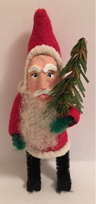

- Finished CBS approximately 3" tall
- CbS 3.jpg (96.71 KiB) Viewed 178362 times

Wow! Looks like it just came out of a 1930's WoolWorth's 5¢ & 10¢ store Howard! Impressive. I gotta try my hand at this project!
Re: Candy Box Figurines
Very authentic looking

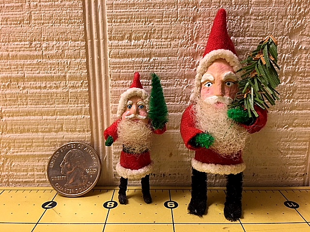

Greetings to all…
Here’s a much smaller “candy box” style Santa figurine I just finished using basically the same techniques as the first ones I made at the end of 2017...
This smaller one has a cast face versus a cardboard one…and a body form made from a short length of 5/16” diameter dowel I shaped to a cone point…the fabric wrap was replaced the red felt this time…
This smaller Santa will grace the front of the new, very tall church I’m presently working on…
https://www.cardboardchristmas.com/foru ... f=2&t=1525
My very best regards…
- small santa 2018 large santa 2017.JPG (209.55 KiB) Viewed 178065 times
- small santa march 2018.JPG (215.05 KiB) Viewed 178065 times
