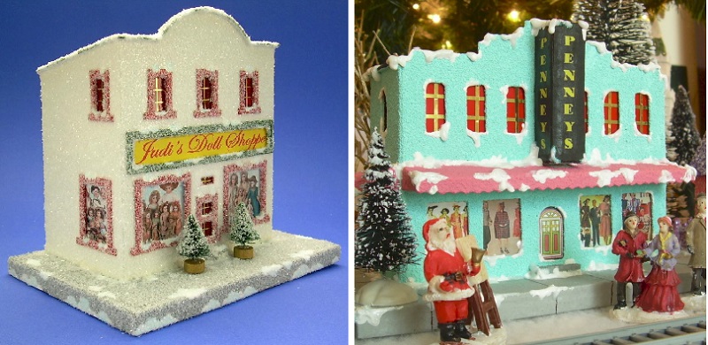

I have made several "picture window houses"...the images were printed on copy paper...here is the link... http://littleglitterhouses.com/paul/pic ... _house.htm
Scroll down to the instructions about making your own picture windows...you'll just need some images...I'm sure you can google and find what you're looking for...
here are a couple more "picture window houses" from way, way back...the window were printed on copy paper...
- picture-window-houses.jpg (189.31 KiB) Viewed 21274 times
