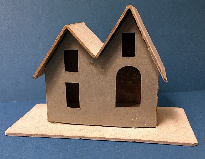

first...here is house number 7 in the series of 12 ten cent city houses...see the photo and the PDF below...i'll post a picture of the completed house shortly...
second...looks like i'll be adding more houses to the series of 12 that i originally planned...perhaps 4 more...stay tuned...
attention: Deb...i added the 1-inch square to the pattern sheet...see the REVISED pattern sheet below...howard
ten cent city house 7 REVISED see topic copy.pdf- this pattern sheet has the 1-inch square added at the request of Deb
- (19.07 KiB) Downloaded 1853 times
- ten cent city house 7 raw cardboard.JPG (169.91 KiB) Viewed 30334 times

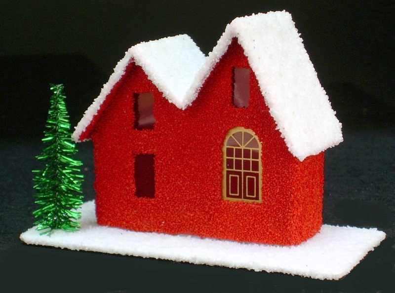

here is the completed July house...it's number 7 in the series...i'll let the photo tell the story...
i will be posting the next house in the series in a week or so...
- ten cent city house 7 july.JPG (146.27 KiB) Viewed 30286 times

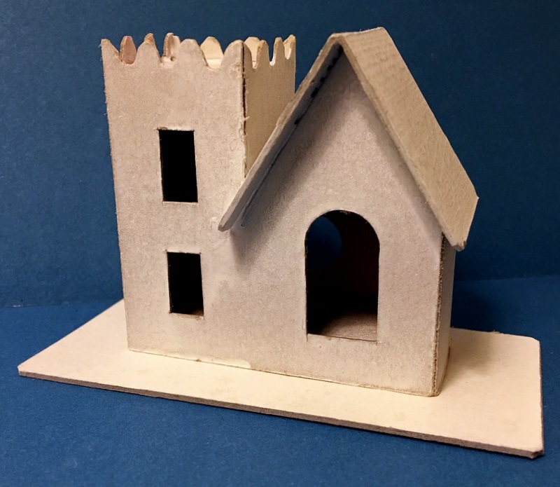

here is house number eight in the series...it's shown in raw cardboard in the photo below...you can download the free pattern in the PDF file...i'll post a picture of the completed house in a week or so...
- ten cent city house 8.JPG (161.41 KiB) Viewed 30212 times

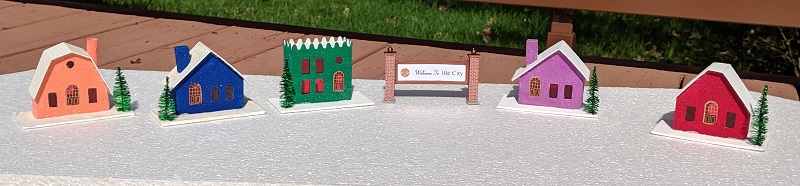

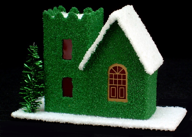

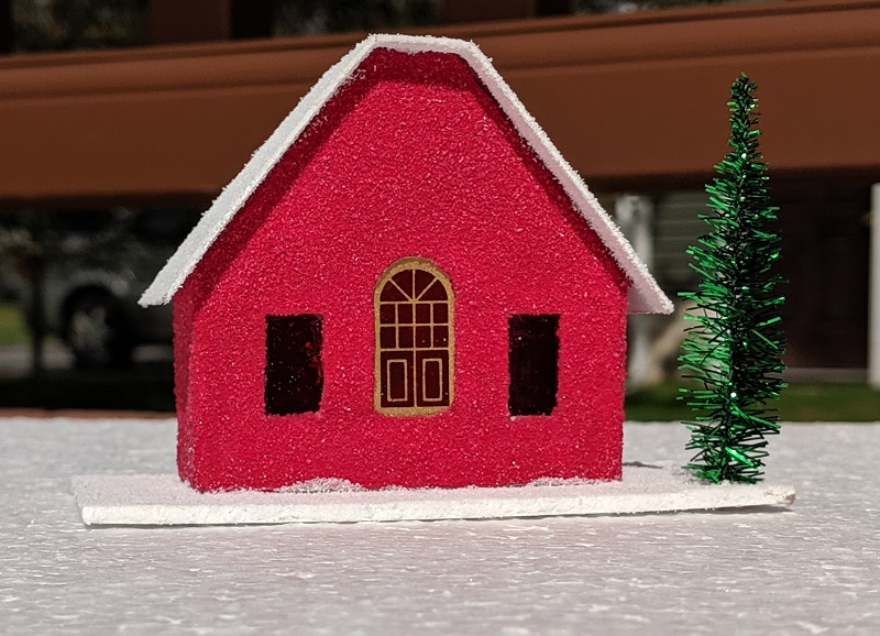

A little late into May. But here's my May house.
And here's January to May all in a row.
Now to get a head start on June.

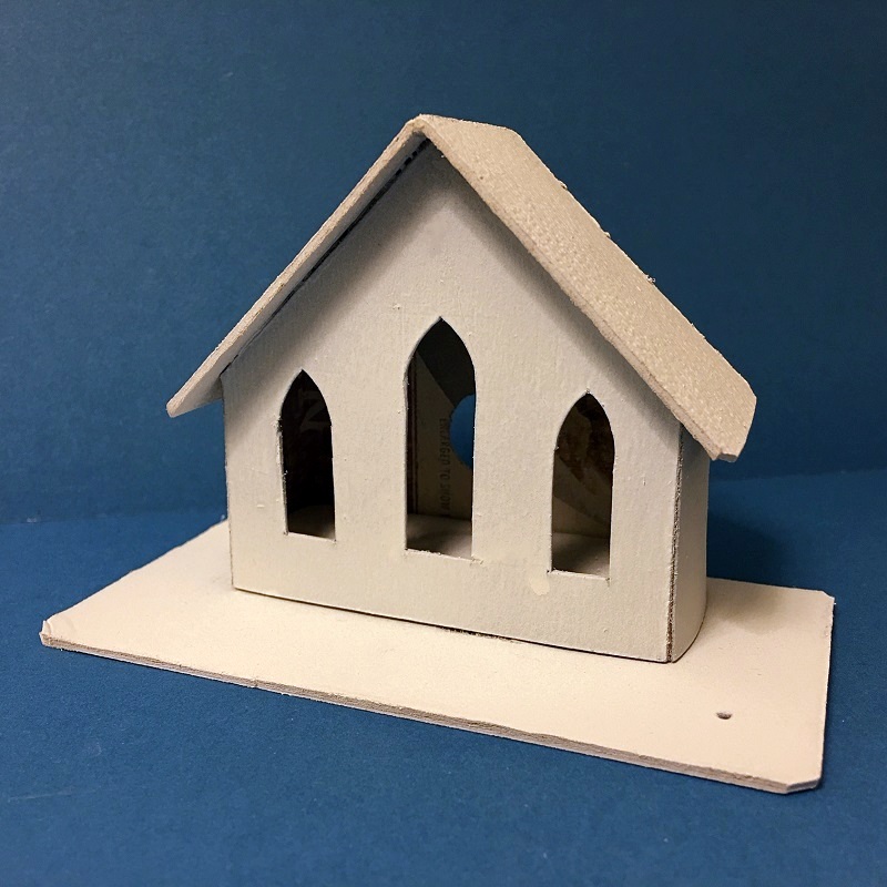

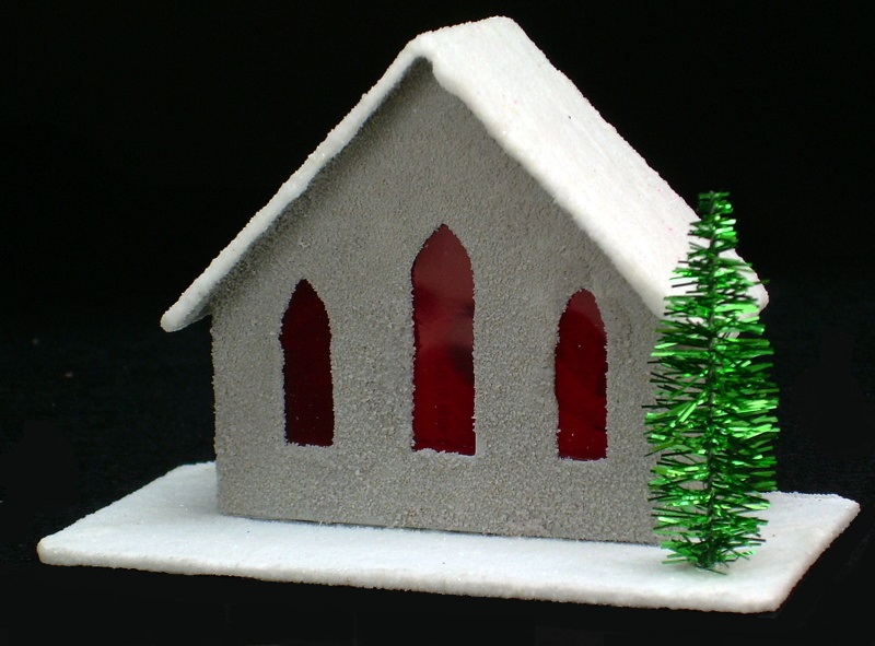

update...5/24/2019...
here is the completed house/church...it's number 9 in the series...i know the gray looks a little drab by itself...but it's a nice color contrast to the other houses in the series...and...i still need to post a "family portrait" of the completed houses so far...
working on the next house right now...hope to post a picture and pattern next week...
- ten cent city house 9 september.JPG (143.49 KiB) Viewed 29940 times
