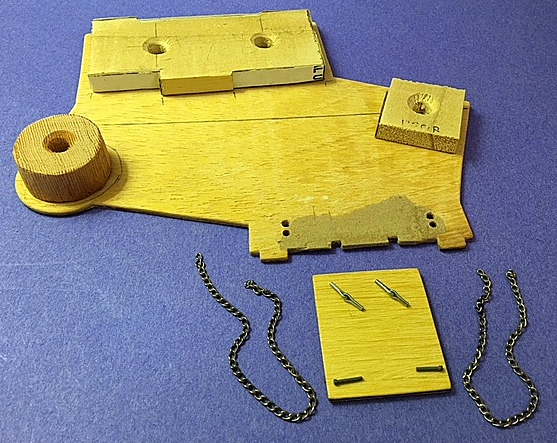

made the following : plateau with foundations for the house and two towers...drawbridge, chains, hinges and pins to hold chains...
still waiting for the LED lights...then i can continue the paper mache...

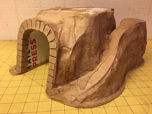

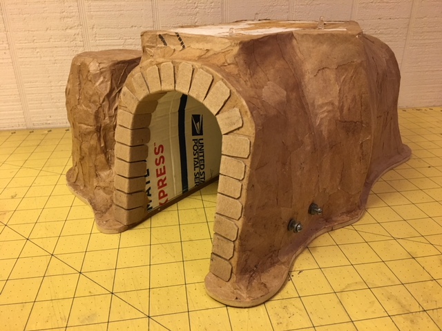

finished the paper mache and added the folded cardboard bricks to the portals...the two screws in the photo are for the electrical connection to the LEDs...
still working on the castle fence and a few details...i'll post a picture or two tomorrow...

- tunnel-portal-power- terminals.JPG (127.01 KiB) Viewed 23366 times

the terminal block is "old school"...(but it works)...it's glued inside the skin of the paper mache and attached to the base and side strip of the tunnel...yes...all the wires are inside...
the LEDs are glued in holes in the plateau with white craft glue...don't use hot glue...(hot glue will destroy LEDs)...the sleeve of cardboard around the LED is to take up any space that the glue won't gap...(it's easier to thread a little 5mm diameter LED mounted on very fine wire thru a big hole and fill in the space with a sleeve)...

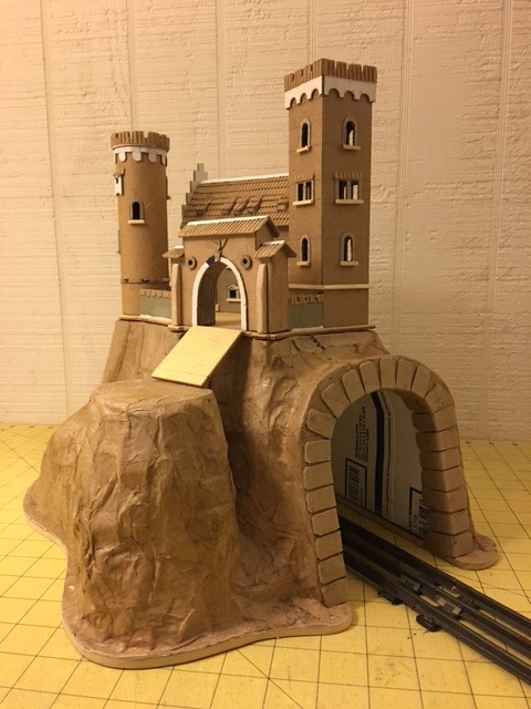

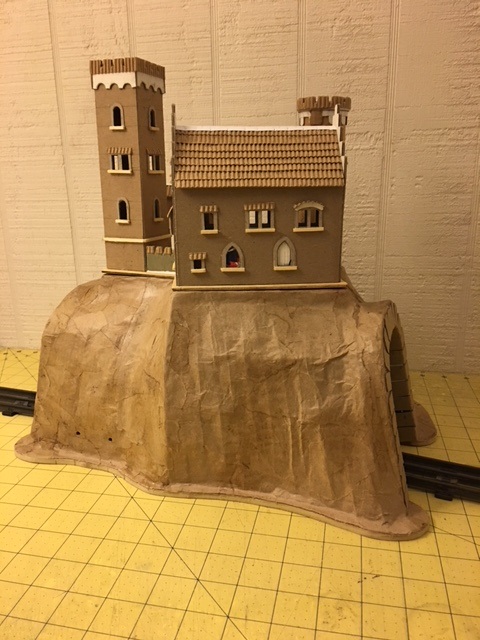

update...10/15...

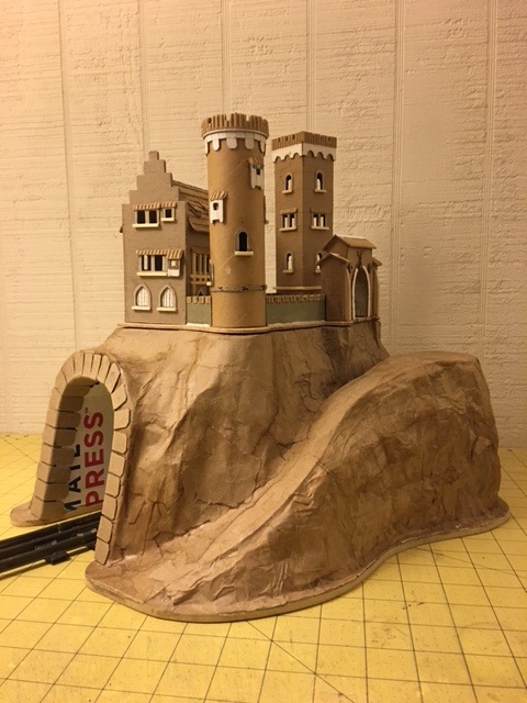

three views of the project...it's ready for the first coat of primer...
- castle-tunnel-primer-ready-left.JPG (114.09 KiB) Viewed 23332 times
- castle-tunnel-primer-ready-right.JPG (125.94 KiB) Viewed 23332 times
- castle-tunnel-primer-ready-back.JPG (115.17 KiB) Viewed 23332 times

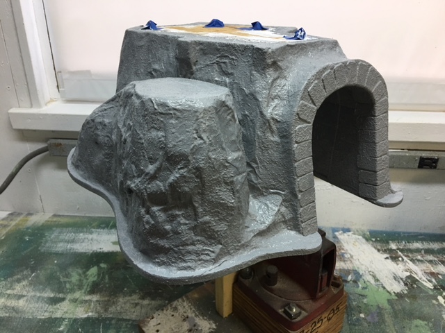

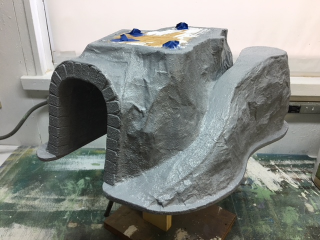

update...10/17...
added a well brushed in coat of white primer...and a coat of anti-skid floor paint left over from painting the shop floor...the anti-skid texture in the paint looks and feels just like pebbles of sand...
details are next...painting the rocks, road, tunnel portal and grassy areas...but don't want to over do the detail too much...and take away from the castle...
hope to start painting the castle parts soon...
here in north florida...enjoying our first taste of cooler air in months and months...
