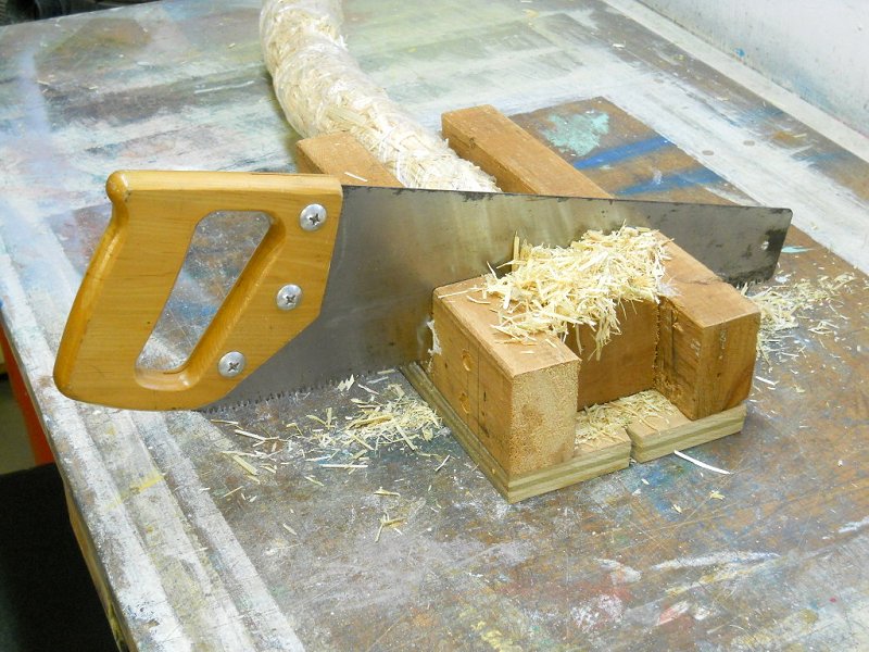

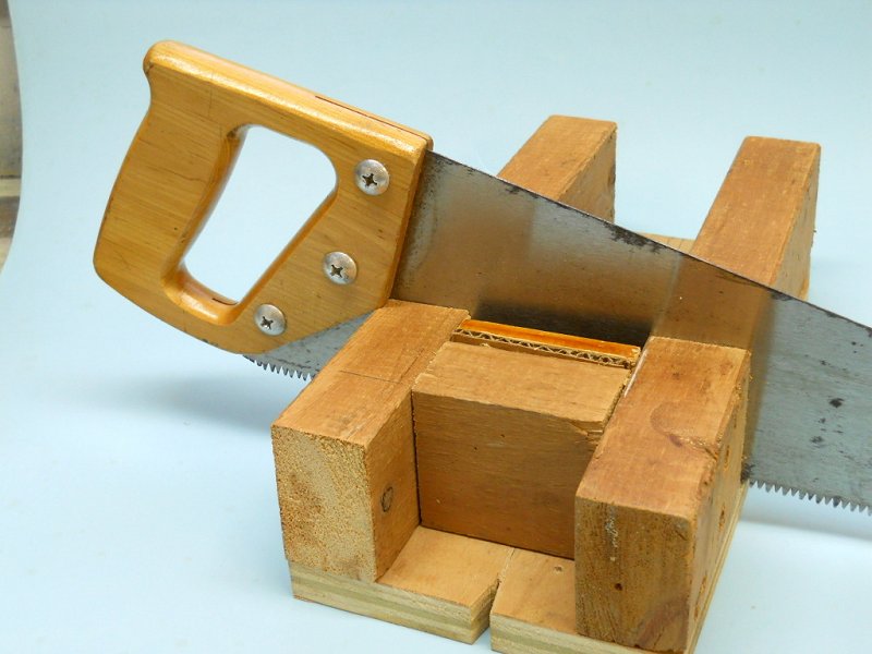

The next step is usually pre-cutting to get your straw bits down to less than an inch so you can chop them into coconut-sized bits with your food processor. One contributor who makes his coconut from these wreaths cuts them once to make them into a "log," then feeds the log through a jig he's made that's kind of like a mitre box, using an ubersharp hand saw to cut the straw to >1" links.
I'm working on an article with more detailed information, but I wanted to give you a preview:
rough_cut_jig_coconut 005-001.JPG (66.34 KiB) Viewed 75602 times
rough_cut_jig_coconut 006-001.JPG (121.53 KiB) Viewed 75602 times

LOVE the straw saw!! :) I'm going to have to work that into my method for sure!!
Re: Educated Guesses: What I've learned about Coconut so fa
Brian, we have more on the straw saw on this page now:
http://cardboardchristmas.com/html/coco ... rials.html
