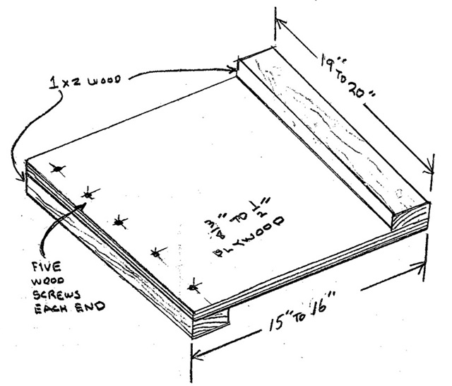

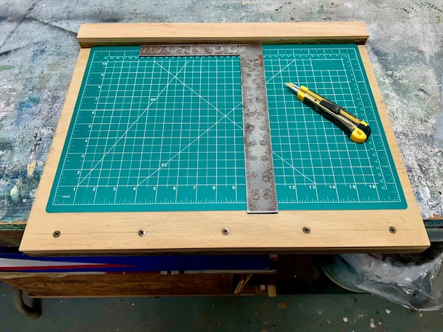

The version I built is designed to fit a 12” x 18” cutting mat, which I purchased from Amazon. I already had an 8” x 12” carpenter’s square. For reference, please consult the rough sketch and accompanying photo provided below. It is important to note that the rough sketch is not drawn to exact scale, and precise dimensions are not crucial as long as the basic details are followed.
cardboard and paper cutting board.jpg (150.59 KiB) Viewed 20483 times
