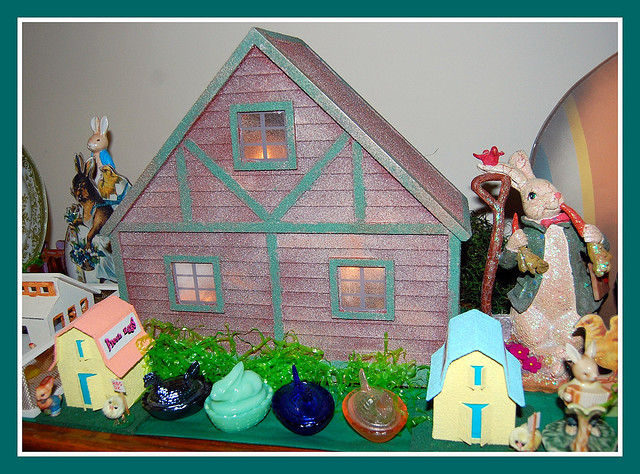

Re: Sand coating
I think both Howard and Maria have great ideas about using sand. I have used both sandbox sand and white floral sand and like them both. I wanted a stucco or adobe type finish (Southern California, you know) so I simply mixed a pinch of sand in with a small amount of paint in my painting palette (the plastic lid to a pint food container) and painted it on after I had primed the house. When it dried I scraped the window edges to clean them up.
Also used both sandbox sand and a coarser construction sand we had left over to add to paint for the snowy ground. And glued it to orange paint for a gravel path.

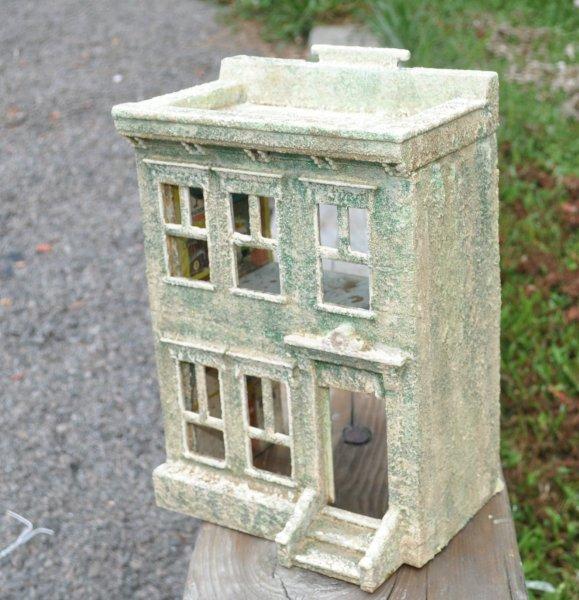

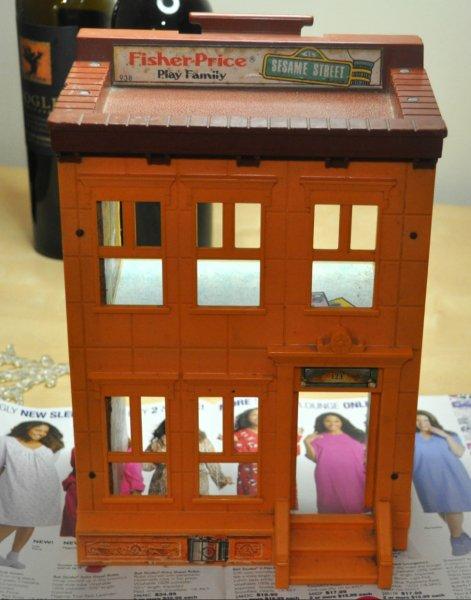

Here's a "trashbashing" project I'm working on - read about trashbashing again at http://www.familygardentrains.com/prime ... shbash.htm
Anyway I found this fisher price piece at a tag sale for a dollar (there' a store too and I am holding it on the side). As you can see, it's a work in progress. It's very large and will probably go with my antique feather tree putz this Christmas as a solo piece.
Here's the original; here's what I have done so far. I wanted to achieve a very old look; next stop, windows, door, glitter, decorations, base
