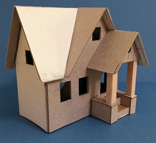

update...10-10-2018...
here's how the classic cottage looks with the major parts completed...the chimney and dog house are not shown...i will permanently attach the steps and posts assembly plus the dog house after everything is painted and glittered...still working on the base...and drafting the pattern sheets...

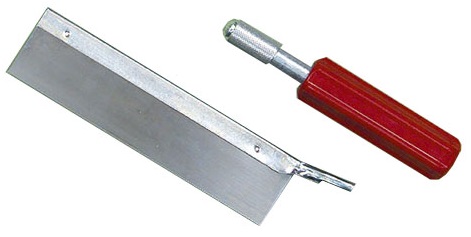

Howard,
I have a kind of dumb question. How do you make such nice cuts on the dowels or wood pieces? I've used garden shears which squashes them, a Dremel tool which doesn't do much better and a craft knife which doesn't work well either. If I go to my brother's shop I can cut them with one of his saws, but that's kind of overkill and dangerous when cutting tiny pieces.
Posts: 2386
Re: Classic Cottage with front porch similar to July 2006 HO
Lucy wrote:Howard,
Here's the tool i use...http://www.xacto.com/products/cutting-s ... ail/X75300
I'm certain the craft store sell (in store and online)...i know they can also be ordered online through Walmart and Amazon...

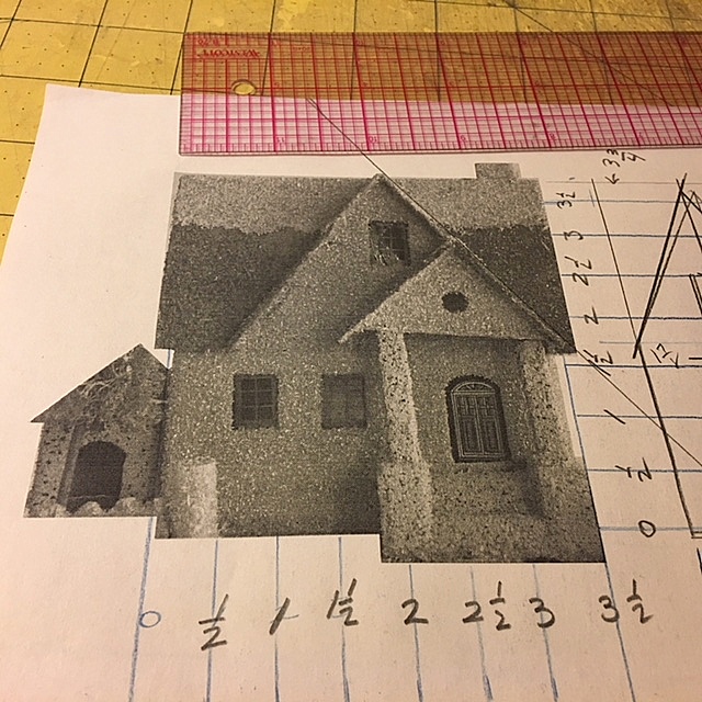

update...10-12-2018...
while i'm drawing the pattern sheets for the cottage, thought i'd share the "old school, analog way" i start the process...(apologizes the technically fluent CAD folks :lol: )...
i start with the best front view photo i can find...then trim away the base, fence and landscape...knowing that most doors are about 1/2" wide, i use that as a starting point and guide to deciding the width of the house and other basic dimensions like walls and peak height...of course there is some guess work and adjustments to dimensions and proportions now and then...it's not a perfect system...but it works for me...
hope to post the pattern sheets on saturday...

Lucy,
In addition to the saw that Howard shows, I use a small miter box that I got from Micro-Mark. It makes very nice straight and angled cuts, and help to keep your fingertips out of the project!
