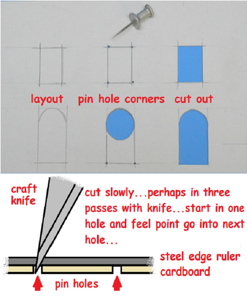

Here’s a simple technique I use to cut window and door openings…I know there are other ways…and they all work…but the method outlined below works well for me…it’s quick and accurate…and the finished corners are really sharp and clean…
1. Layout the opening…use a pencil with a sharp point and a good ruler…I use the C-Through brand number B-70...
2. Define the corners…use a standard push pin…these small holes become the corners…see the photo below…I have a series of round hole punches for the top arch of doors…
3. Cut out the opening…a sharp craft knife and a steel edge ruler are recommended…put the tip of the knife in one hole…slowly make the cut in several passes to the next corner hole…you’ll actually “feel” where the cut stops when the knife tip reaches the hole…
You might want to practice on a cardboard scrap to get the “feel” of the knife starting in one hole and finishing in the next one…
cutting windows doors.jpg (150.72 KiB) Viewed 50262 times

I will personally vouch for Howard's method, it is GRRrrrrrrrEAT! He sent me details a while back and I have used it on ALL but one of my houses with paper mullion windows. You can really feel when the tip of the blade hits the pin hole letting you know to STOP! :) Having a brand new sharp blade is key.
