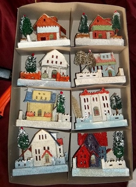

I have nearly a complete set of the so called Fair Set - lacking only the church but with one variation of one of the houses so enough to justify building an original type box for them for storage. This does one of two things. Provides excellent protection for the houses AND for anyone that follows me groups them together for posterity. Something we all need to think about. I have done this before but not quite in the same way. I used full enveloping lids on those but this is a duplicate of the authentic antique originals that I own. It is custom made to this set of houses. These houses all measured the same length depth and height. by adding 1/2 to 1/4 inch to these dimensions (except for the depth) I made a fairly tight fitting box with an authentic style lid.

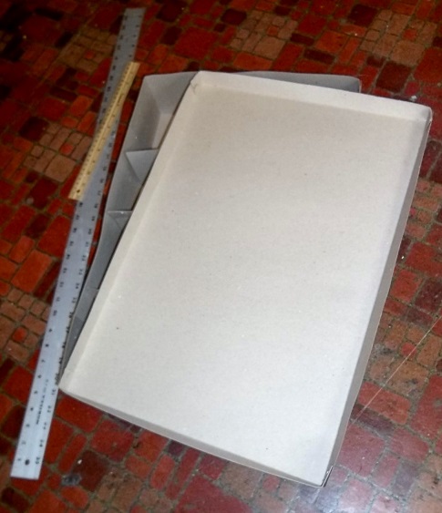

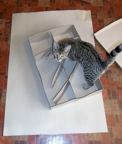

Photo one shows the set together in the box. This is also great for display as well. Photo 2 shows the box and the separators lying on the size of sheet of cardboard I was using. It took a bit over 1 1/2 of these sheets. This is a fairly large box. The cat's name is Coaly. My old momma cat had 3 snowballs and a lump of coal hence Coaly. The three snowballs turned out to be lovely lavender points. Photo 3 shows the lid lying on the completed box.

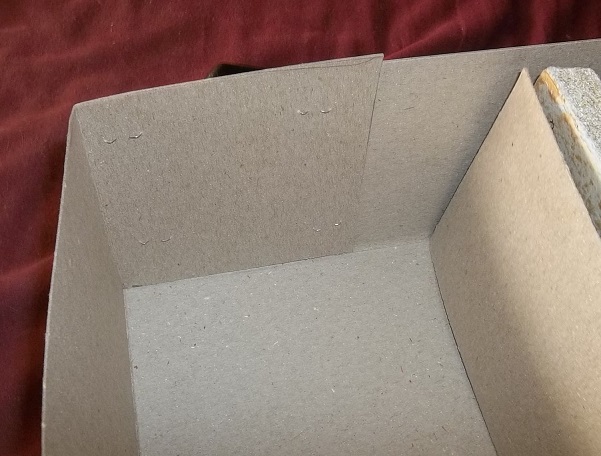

This first photo shows the method of stapling the box together that I used. This seems to have been a fairly common method though some were glued together. Your choice. I also used this on the lid though perhaps glue may be a better choice.

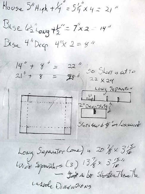

In the sketch below the solid lines are to be cut and the dotted lines need to be scored and folded. This layout is basically the same as that needed for the lid except my lid has a 1" lip.
The next two photos are the specifics that I used to make this box. HOWEVER your box may be different. The way you determine the floor of the box (which is the base from which everything else follows), is to multiply the length of the base by 2 and add 1/2" to each house or in this case 6 1/2" + 1/2" = 7" X 2 = 14". This is the width of the box. To get the length I measured the height at 5" and added 1/4" to come up with 5 1/4" Multiply this by 4 and that = 21" So the bottom of the box is 21" X 14". The depth of the base of the houses is 3 3/4" + 1/4" = 4" so the sides are 4". Though I got this last set of figures wrong on my layout sheets below the information is basically correct.
The separators were made 1/8" shorter than the length and the width and 1/16" lower than the 4" edge of the box. As I said everything is based on the basic dimensions in this case 21 X 14 X 4. The slots (it takes 3 slots on the long separator), are about 1/16" wide and a bit over 2" deep.

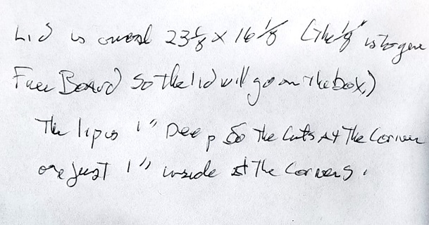

For the lid I wanted about a 1" lip around to going back to the basic dimensions of 21" X 14" gives 23" X 14" AND then added 1/8" to either dimension to give an overall freeboard so the lid will go OVER the box. This is important. You don't want it TOO much over but it does need to be some over. This one fits pretty tight and is a bit hard to put on BUT it stays on too which is an advantage.
Remember if you are going to do this (I SHOULD HAVE PUT THIS FIRST) MAKE SURE YOU HAVE A SET OF HOUSES WITH THE SAME DIMENSIONS. They don't have to be exactly the same but at LEAST 1/8" of each other. You may have to enlarge your basic dimensions if you houses aren't close enough alike. I would suggest using the LARGEST dimension of a house if they are not the same. ALSO that is what THESE houses needed. Yours may (and undoubtedly are) have different dimensions. There are at least two other sizes of bases to these Fair Set buildings but I have the most common ones here. One was bigger and wouldn't have fit.
