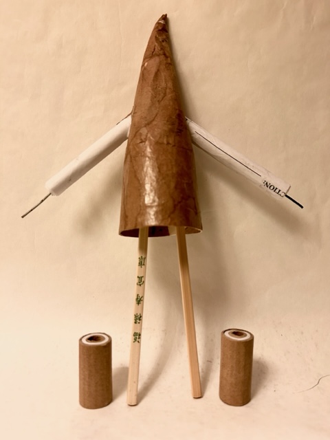

BODY…Cereal box cardboard cone covered with layer of paper mâché…there is a 2” wide horizontal slit centered on the back…it’s 3 1/2” down from the tip for the wire arms armature to slide into…a corrugated cardboard oval, with holes for bamboo skewers, is glued inside of cone 1/2” from the bottom edge…see the PDF...
I’ve used the rolled cardboard cone Santa body technique for two previous projects…I'll post links later when I update this topic...
LEGS…Two 1 3/8” long cardboard tubes, salvaged from a clothes hanger, wrapped with paper strips and glue to increase the diameter to 3/4”…
BODY AND LEGS ARMATURES…Bamboo chopsticks run from inside tip of body cone, through cardboard oval, leg tubes, carved wood boots and base…armatures are cut flush with bottom of base after final assembly…
ARMS…Strips of paper wrapped and glued around an armature of salvaged “survey flag” wire…these flags are used to mark underground utilities, etc…strips of paper mâché were used to reinforce the joints where the shoulders meet the body and also cover arms armature wire slit…

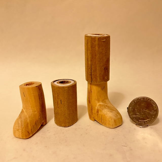

BOOTS…Carved from 5/8” thick, soft wood…I used a Dremel rotary tool with a sanding drum and then hand sanded to smooth out the contours of the boots after rough carving with a knife…there is a hole through the center of each boot for the leg armatures…a 3/8” wide band of cardboard goes around the top edge of the boots…

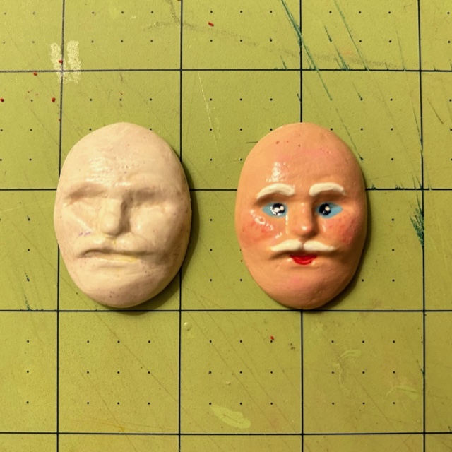

FACE…Measures 1 1/2” tall x 1 1/8 inches wide…It’s a homemade one since I couldn’t find the exact size needed…it was done in several steps…I'll post links to the products listed below later...
1…Model/sculpt face with Sculpey polymer clay and oven dried per instructions that came with the clay…
2…Make a modeling clay push mold of the oven dried Sculpey face…I use dollar store modeling clay…mist the mold with non-stick cooking spray…put mold in the freezer for about 15 minutes…
3…Cast with Durham’s Rock Hard Water Putty…the cold cooking spray will give you a clean release of the casting when the water putty is dry…
4…Paint face details…I used clear fingernail polish for a glossy final finish…

Update...8/2/2023...
The carved and smoothed boots...I used super glue to attach the legs to the top of the boots...not shown in the photo are the 3/8" wide bands of cardboard that go around the top of each boot where the legs join the boot...more detail photos to come...stay tuned...
- santa 3.jpg (93.38 KiB) Viewed 28388 times

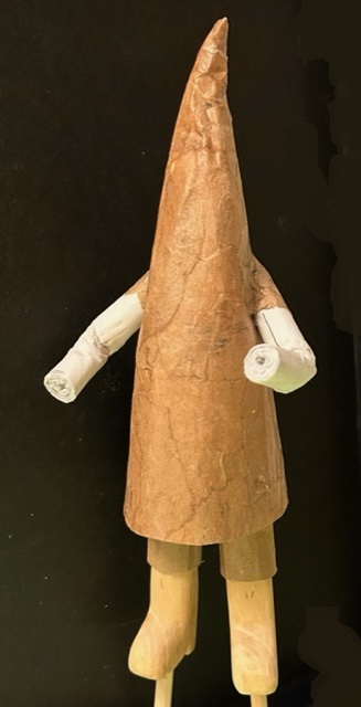

Update...8/3/2023...
Starting to look more like a figure now...arms are posed and cut to length...you can see the paper mâché reinforcing where the arms meet the body...more construction updates later...stay tuned...
- santa 4.jpg (77.89 KiB) Viewed 28354 times

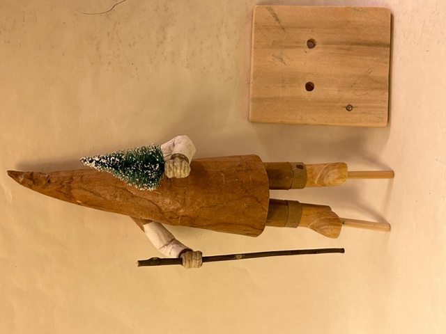

Update...8/7/2023...
I'm updating this topic much faster than I thought...I'm doing everything I can to get my mind off my backyard temperature of 101-degrees just a little while ago and a "feel like temperature" of over 120-degrees...yuk...
I think you can see how all the parts are starting to come together...body, base, walking staff and tree...more photos later this week...
- santa 7.jpg (82.84 KiB) Viewed 28228 times

Update...8/8/2023...
I could not find a Santa face in a suitable size, so I made my own...the one on the left is the master I molded with Sculpey oven baked clay...the one on the right is the painted casting made with Durhams Water Putty and coated with two coats of clear finger nail polish...not shown is the modeling clay push mold made from the master...here are some helpful links to the process and products used...
https://www.sculpey.com/products/original-sculpey
https://www.cardboardchristmas.com/foru ... h&start=10
https://durhamswaterputty.com/casting/
Stay tuned for more updates...
- santa 8.jpg (173.24 KiB) Viewed 41651 times
