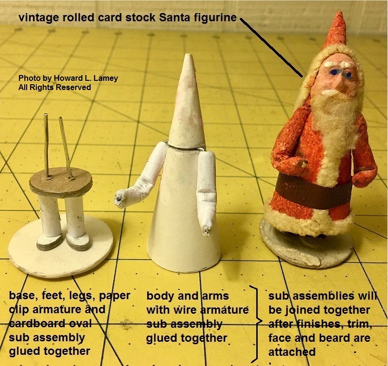

I knew at once that the Santa figurine was something I had to reproduce…I think the photos and these details will help you make your own version…

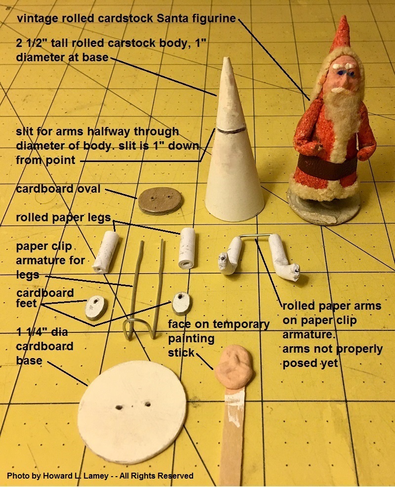

BODY…2 ½” tall rolled card stock cone…1” diameter at base…slit in the body 1” from the pointed top that cuts the body almost in half…this slit is for the arm wire to slide into…
LEGS…rolled paper tubes about 5/8“ long…you can see the paperclip wire armature, base, feet, legs and cardboard oval in the photo…
ARMS…rolled paper tubes…each approximately 1 ½” long…glued to paperclip armature wire with about 1/2” space between them…cut to a more realistic length after being bent at the elbow and posed…
FACE…mine is a reproduction…I made a modeling clay push mold from a vintage original, cast several using Durham putty then painted the facial details…

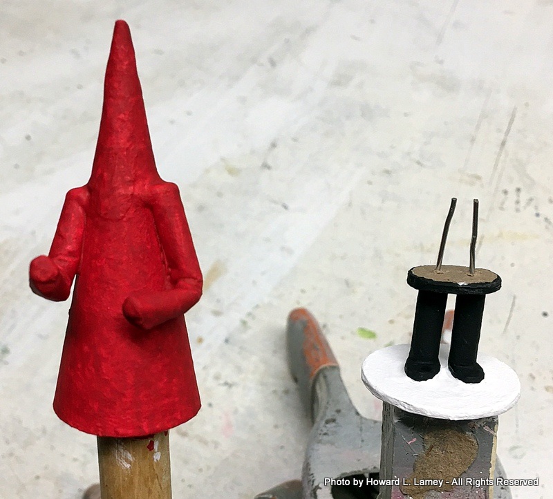

BODY FINISH…primer, red craft paint and extra fine grain red sand…green craft paint for mittens…
LEGS AND BASE…primer, black and white craft paint plus glitter on white base…

Note…the body cavity of the vintage figure was lightly stuffed with crumpled tissue paper from the top of the oval on the leg sub assembly to the tip of the cone…I did the same thing to mine…but I had to poke small holes in the crumpled tissue for the two lengths of leg armature wire to slide into…

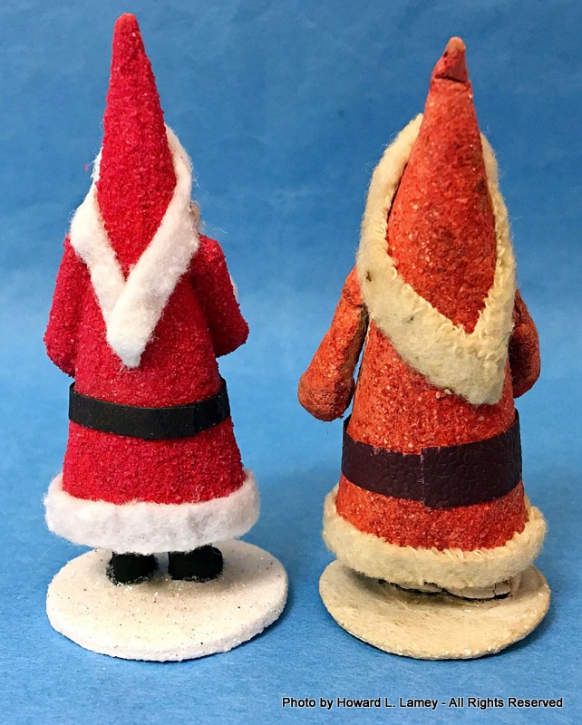

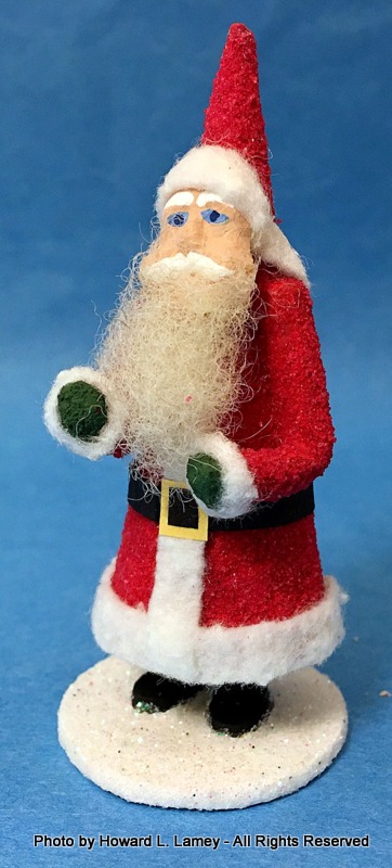

update...2-5-2021...
here is my finished version of the rolled card stock cone Santa posed by the vintage original for comparison...i imagine he'll age over the years and mellow out...red pigments just seem to really fade...i really need to put a small tree in one of his hands...

Re: 2021 ROLLED CARD STOCK CONE SANTA FIGURINE...
Howard, this is wonderful! Where did you get the face casting from?
Awesome Santa Howard! May I kindly ask what you used for the coat and hat trim? Looks like true vintage fashion!
Posts: 2386
Clinton...
I used some very old white felt for the trim...it's not a pure white but looks that way in the pictures...it had "aged" a little from being in storage...I almost "aged" it a little more by soaking in very weak tea...but the red dyed sand was so vivid I just used it as it was...
