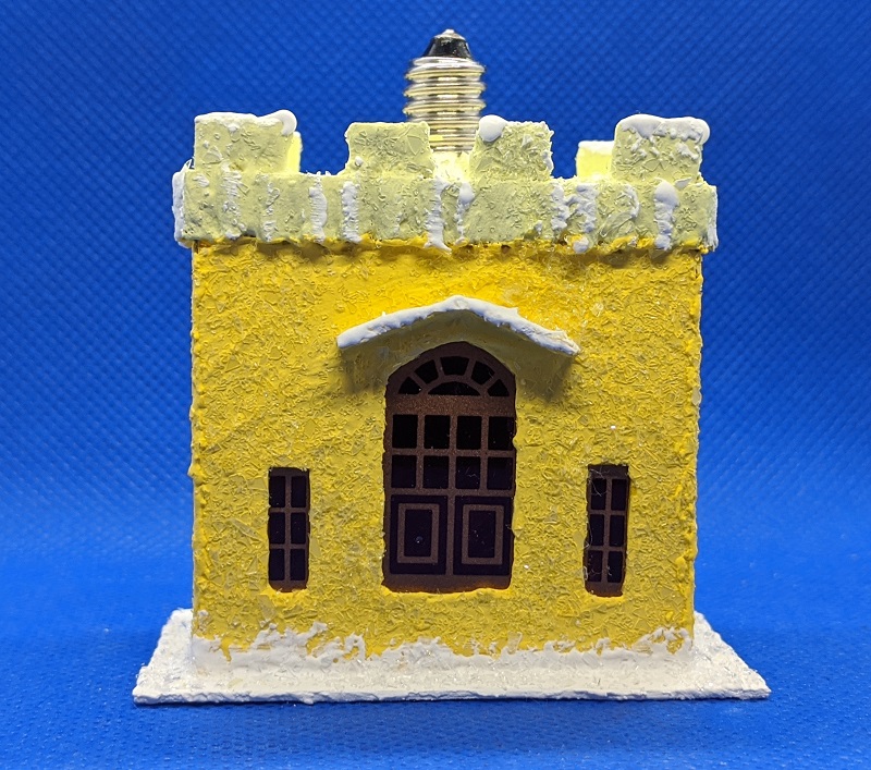

At this moment I'm drawing up patterns to repro the houses.
But also. I am using 12 V LED bulbs. The best part is no heat.
Plus they last a long time.
And also so I am masking my own C6 string. But it is wired in parallel.
So if for some reason if I lose 1 LED bulb the rest of the string will still light.
So here's my test house. Complete with an LED bulb inside.

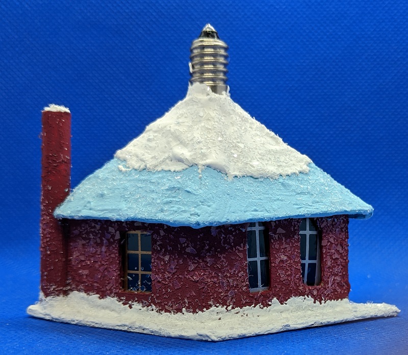

So here's a second house.
I had time between Christmas guests.

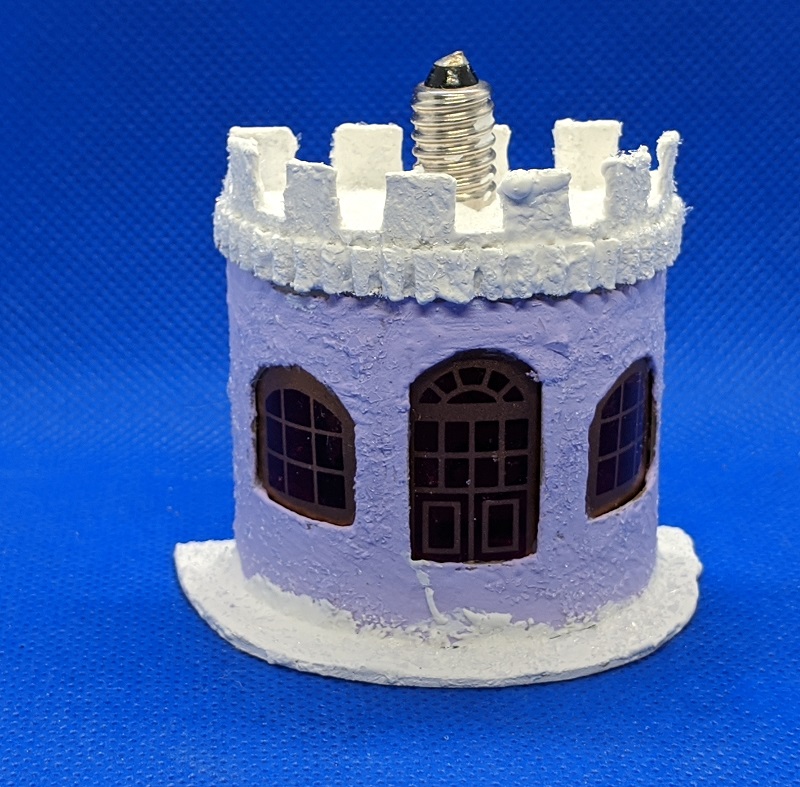

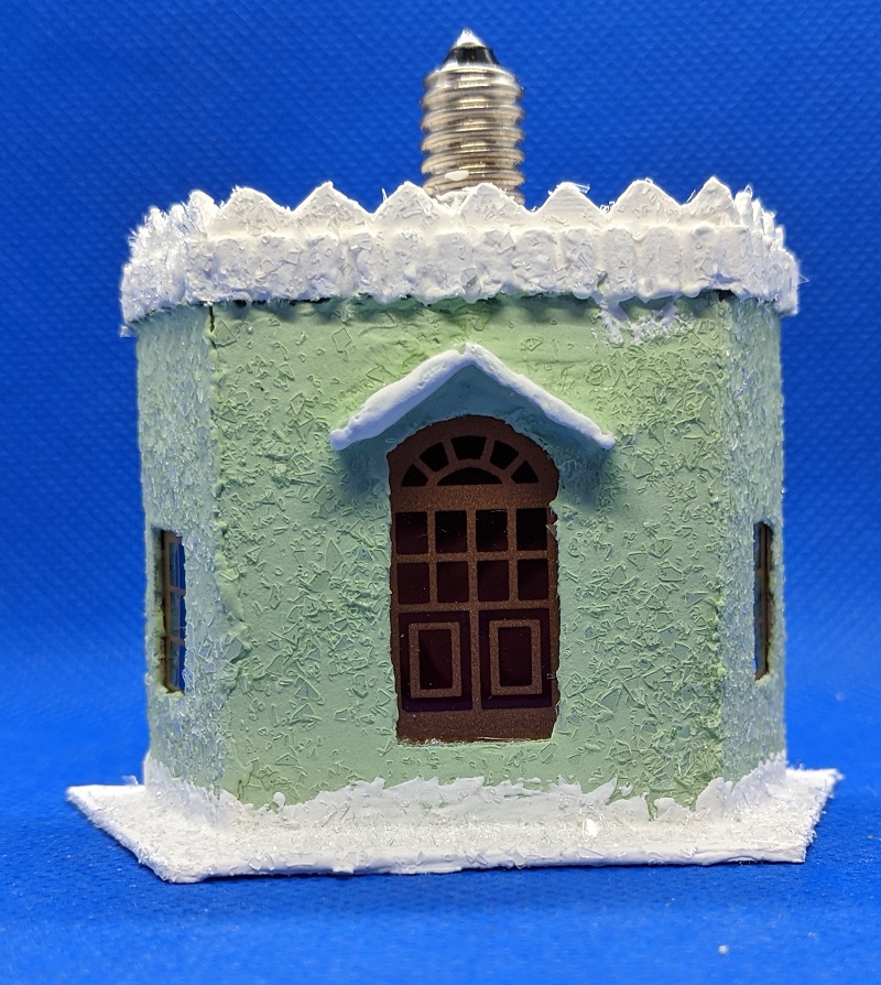

I got 2 more houses patterned up and built and covered.
Still waiting on some supplies for my light string.
The LED's I'm using looks pretty nice. And with no heat.
Still need to make patterns for a few more. eight in total.

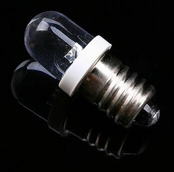

So here's the long shank bulb.
And Below is the LED bulb.

I removed the glass bulb form the incandescent long shank bulb.
then also removed the LED part of the LED bulb.
It was then installed into the long shank base.
A bit of work but I needed the long shank.
If you are just looking for the LED bulbs.
Do a search on eBay for " E10 LED Screw Base Indicator Bulb"
People seem to use E10 and C6 interchangeably.
Where C6 is referring to the bulb and E10 is the socket base.
I am using the 12V warm white version.
