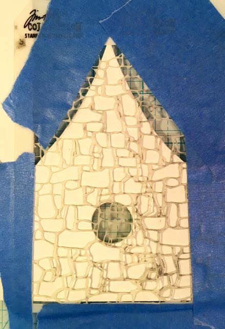

Photo 1. Tape the stencil to one face of the house which has been painted with gesso.
Photo 2. Spread the texture paste on the stencil. Spread it thin enough so you can just barely see the stencil. If it is too thick, the paste will flop over and mush together when you lift the stencil.
No photo for this step. Gently loosen the tape at the bottom and lift the stencil from the bottom up. If the texture paste messes up when you lift the stencil, no big deal. You can just scrape off the texture paste and re-use it.

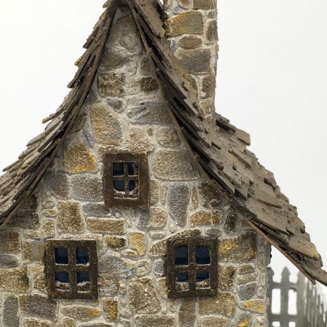

Photo 4 - Paint the background color. I don't want my "mortar" between the stones to be perfectly white so I painted the stones with my lightest brownish gray paint.
Photo 5 - Paint with alternating colors of brown and grey.
Photo 6 - Close-up of the stone texture.

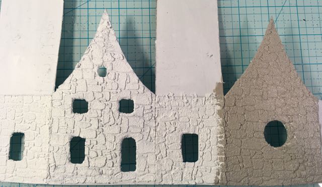

Photo 1. Stencil taped to the cardboard pattern
Photo 2. Texture paste smeared thinly on the stencils
Photo 3. Texture paste stenciled on the cardboard pattern

Photo 5. Paint the stones various shades of brown and grey
Photo 6. Close up of the various colors in the stone
