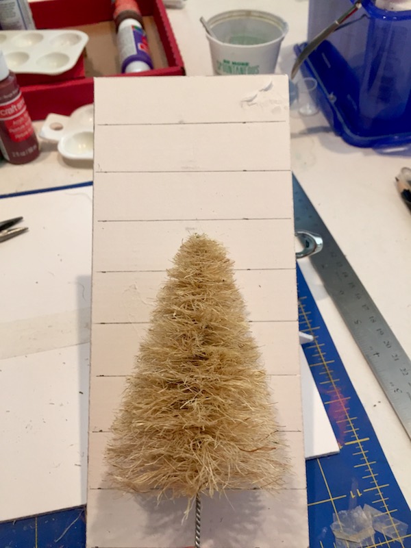

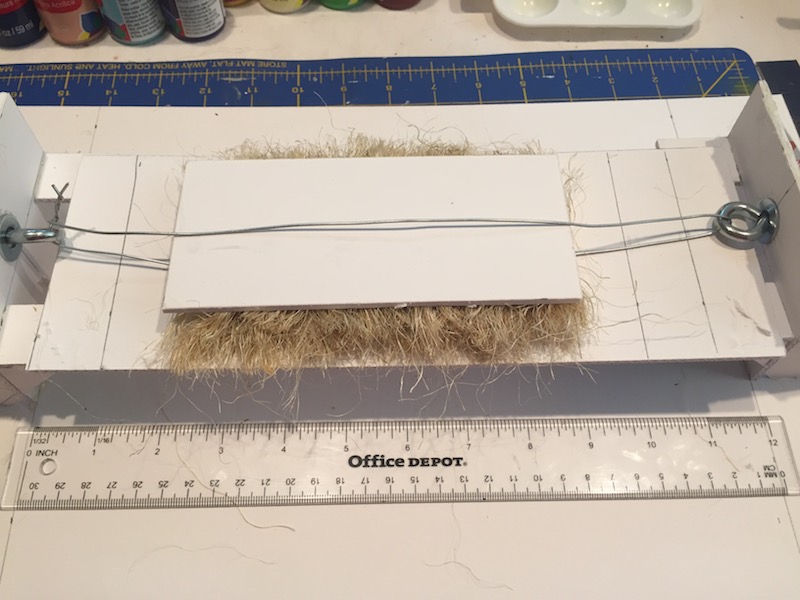

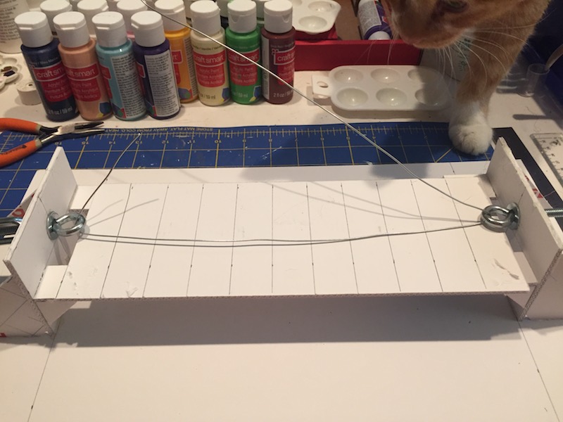

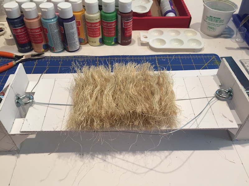

The photos will give you an idea of how I loaded the fiber onto the wire. I have a couple of things I'd like improve -
1. I think I can make cardboard jigs to preload the fibers into before threading the wire through. Hoping to work on that this week. Keeping the fibers from scattering around is a time killer.
2. If the jibs for the fibers work, I believe the wire can cut, looped and dropped onto hooks instead of eye bolts. I think a wood plank with pegs to wrap the wire around after it's threaded around the fibers will accomplish this.

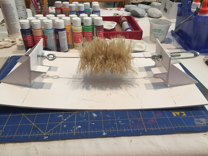

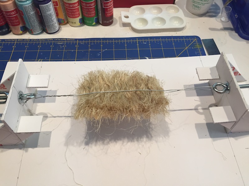

Stuff I found important -
1. I seem to lose about an inch on the trees consistently when they're twisted. Adjust your layout to accommodate for it.
2. Allowing for the shrinkage in the wire is crucial to getting a nice tight spiral. Currently that's being done by loosening the nut on the eye bolt. I tried using a compression spring and some washers. Effective, just need to find the right size and tension.

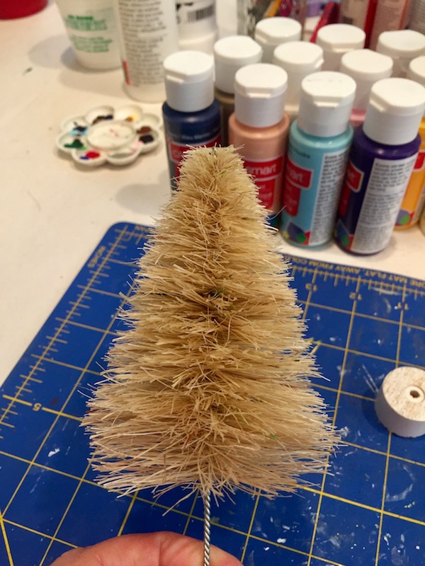

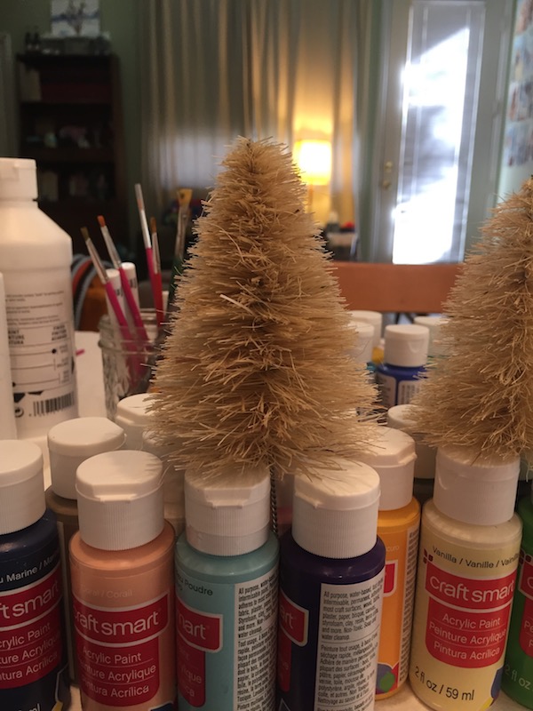

What I found important -
1. Rough cut the shape and use a nylon brush to fluff out the fibers.
2. Dip the tree into boiling water for about 30 seconds. You'll see the fibers straighten out. Set it aside to dry.
3. Once it is dry. Hit it with the nylon brush again and finish trimming. I found trying to brush or cut it while still wet led to having to trim it again once it dried.
Hope this info. helps and hopefully draws out some ideas to improve them. I'll be adding info. on dying, adding snow and bases when I get to them and get some decent pictures.
- Before boiling.
- IMG_0123.jpg (105.76 KiB) Viewed 36467 times
- Boiled.
- IMG_0126.jpg (147.92 KiB) Viewed 36467 times
- Before boiling.
- IMG_0124.jpg (136.01 KiB) Viewed 36467 times
- Boiled.
- IMG_0128.jpg (125.15 KiB) Viewed 36467 times
