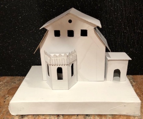

Greetings All - Had a bit of free time this weekend so was able to work on the house. Going to need some time to figure out the right colors for the finish.
A bit of a dilemma though, the pictures that I see appear to be a red/orange color but the description says 'Nice purple and gold fall colors'. Does anyone have this house that could provide some additional description? I think the red/orange color looks good and will go with it if there are no other opinions.

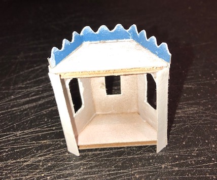

Posts: 918
Re: Making Blueprints for Sept 2005 HOM 'Red Coconut Barn'
Very nice design. I am curious about the space below the uppermost roof. Did you close that in?
Thank you for sharing this information. It's a great way to do a reproduction.
JCass
Posts: 153
Post by JCass »
Hi Lucy - Yes, I just used some corrugated cardboard. The original has it closed in and covered in coconut. It also helped with attaching the bay window and the 'crown' above.
