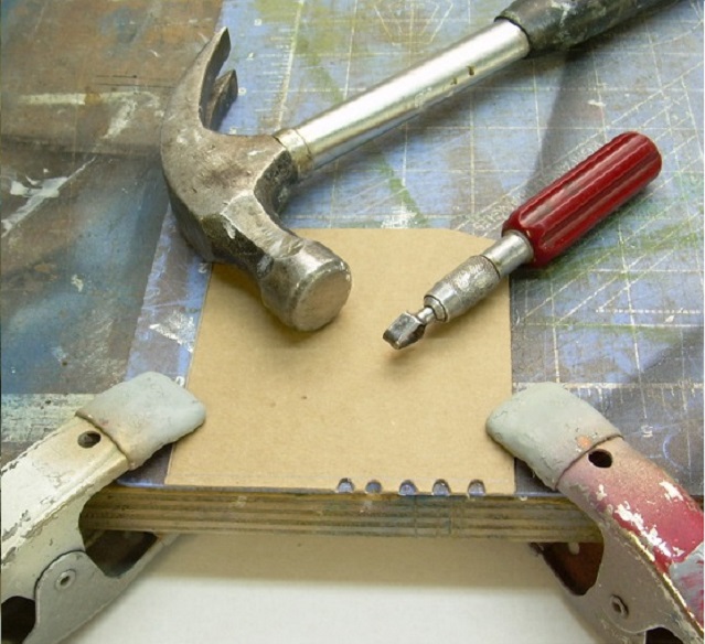

here’s the method i used…(because i already had the tools)…
first, stamp cut the basic shape...a single hammer blow will usually cut one thickness of cardboard...

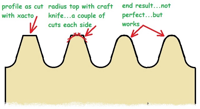

then radius the top of the scallops with a craft knife…
a couple of coats of primer and finish will hide any imperfections in your cuts…
it’s not a perfect solution…but it works…

Wow thats a cool blade, Im going to have to look for that one. I've cut all the fence I've done by hand and its a pain. I did have part of an original to trace which was nice to get the spacing right. You start to feel like a surgeon after so many cuts. :) Very neat, thanks for sharing!
