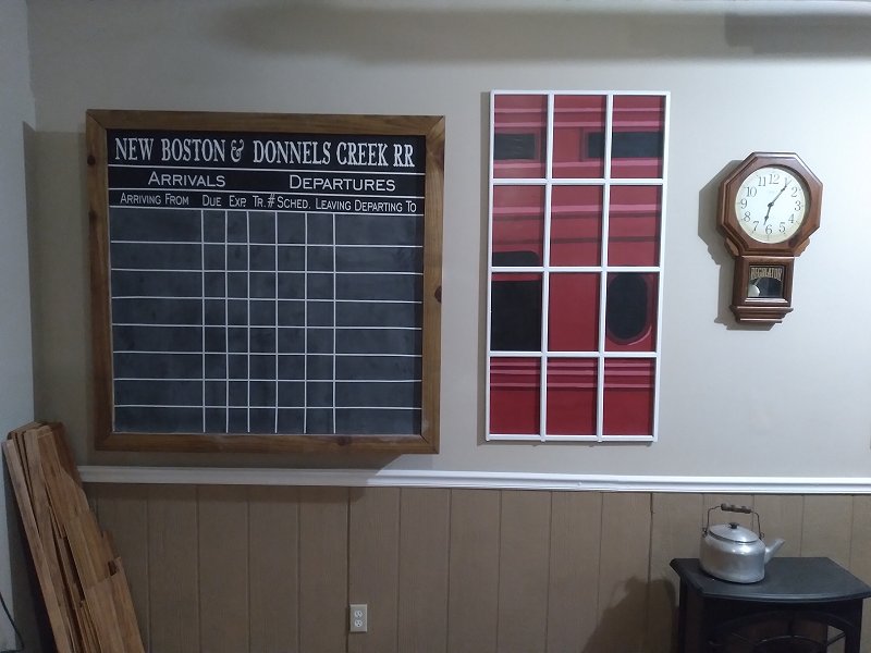

It looks great Paul! So-- the pics of your "train depot" are actually a real room, right?
Re: Cricut update
Posted: Sat Jan 16, 2021 6:33 pm
by paulrace
Thanks, Clinton. The photo of the room is real. The timetable is remaining a mockup until I get the right wood screws to screw the frame onto the "blackboard" piece. (I don't usually keep 5/8" screws around.)

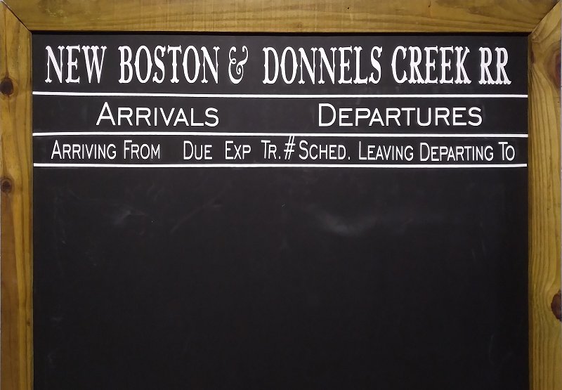

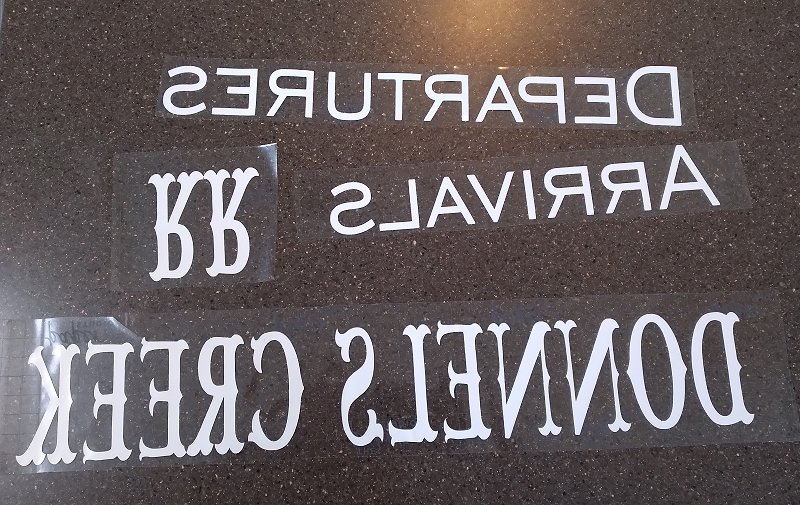

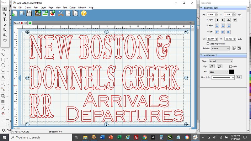

Well, after playing with the first-gen Silhouette Cameo, I went back to my Cricket with an ancient version of Sure Cuts-a-Lot that will operate it. I used Corel Draw to redraw the text with similar fonts I downloaded from the Internet. CF Wild West and Engraver's Gothic BT. (The latter was part of a package I bought, but there are similar free fonts available.) The ampersand was from an entirely different font - Goudy Bookletter 1911 - because I wanted a fancy one.
I cut the letters in adhesive-backed vinyl. Then I used transfer tape to get the letters ready to transfer to the blackboard.
This makes the letters sort of like stickers you can put anywhere (even on the back window of your car).
I carefully transferred the letters to the blackboard, then printed up the next set of lettering I need. I also used 1/4" pinstriping tape to draw the lines.
I now have to rub chalk sideways to "season" the chalkboard part of my timetable. When I'm done with that I will try to see if the pinstriping will stick.

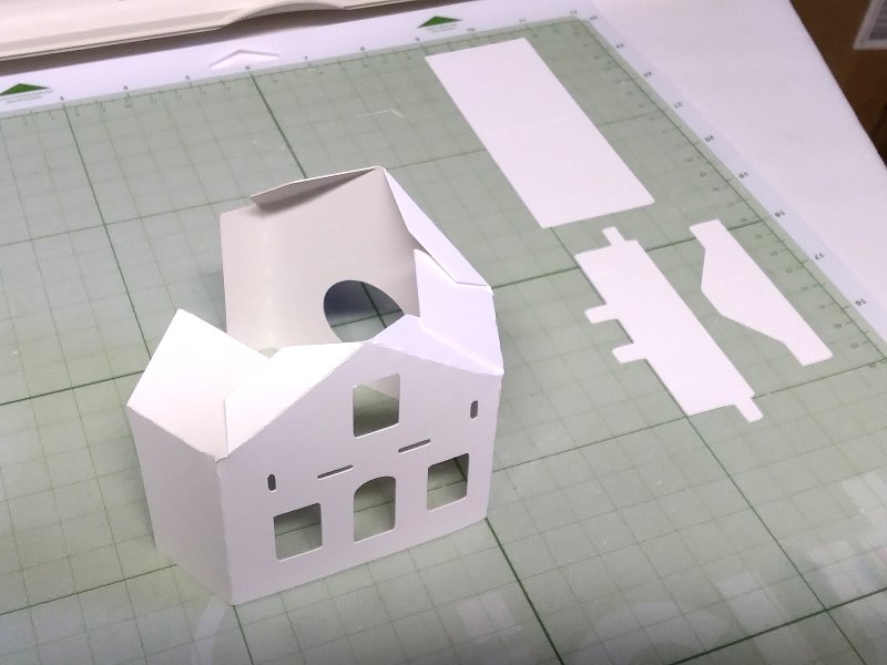

That project made me bold enough to try cutting thin posterboard for a putz house with the thing. Two failures so far, but some progress. The thing with these old Expressions is that lots of owners have abandoned perfectly good machines just because the new Cricut machines and software are incompatible. Since I have backups of my software that DOES work, I don't have to worry about producing a lot of files I won't be able to use when my first Cricut breaks down. No, I don't have two. Yet. . . . .

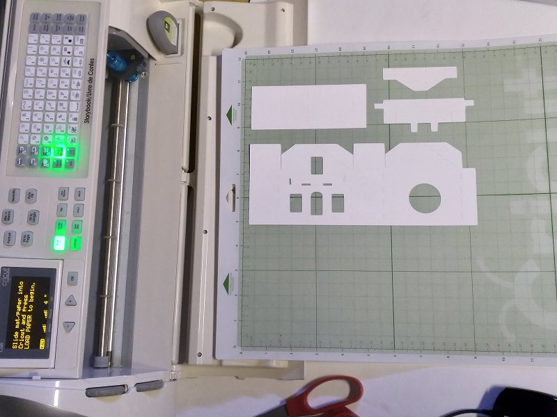

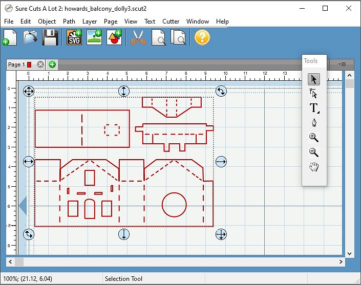

So, I tried the same thing with a "streamlined" version of Howard's Balcony Dolly plan and some posterboard (I bought two pieces at Dollar Tree just for this experiment. They're quite flimsy, but I have to start somewhere.)
This is what Howard's plan looks like on the Sure Cuts-A-Lot screen.
Cricut recommended the blade set to three, single cut, medium pressure.
That scored the posterboard. Also, the dotted lines I had created in Corel Draw cut as solid lines in Sure Cuts-a-Lot. So I went back and made actual dotted lines, as you can see in the drawing above.
I kept setting the blade to higher numbers, and all it did was score the posterboard a little bit deeper.
I didn't go right to maximum settings because I didn't want ruin the blade slicing up the mat.

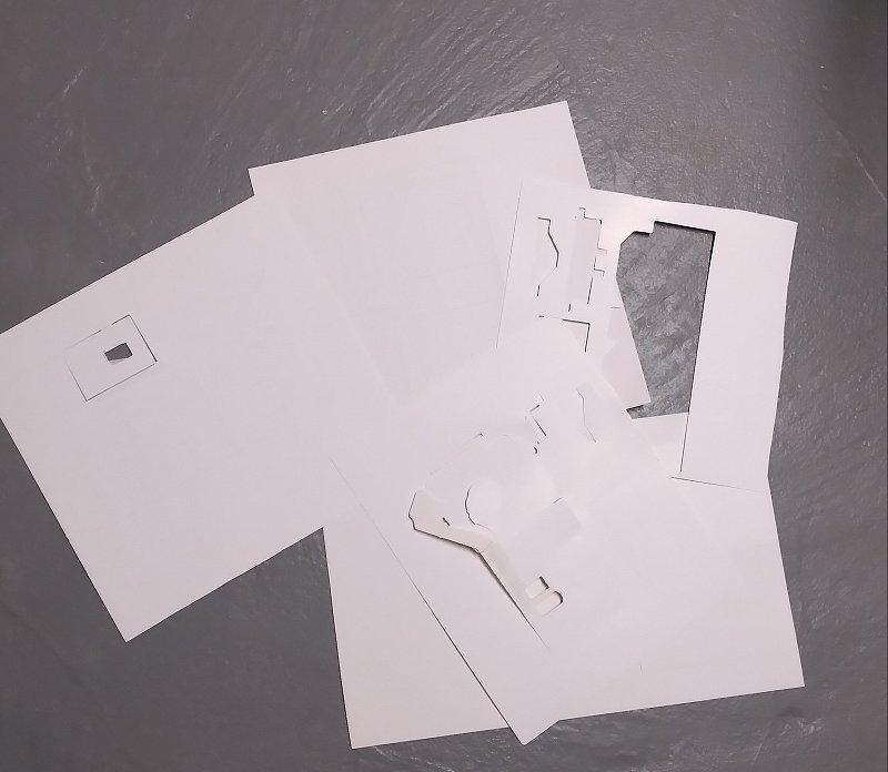

Then I put the "deep cut" blade in and started working my way up. Still just scoring the posterboard for the most part. Eventually a few pieces would be cut deeply enough to pop part of them out, but not enough to be useful. The photo below shows my first four cuts, which used up an entire .50 piece of posterboard. Ask me why I didn't start with something more expensive.
Finally, I set the Cricut's "deep cut" blade to 4, set the multi-cut to 2, and set it to maximum pressure. It worked, and didn't slice up the mat too badly.
After I popped the pieces off the mat, I folded them along the dotted lines I had made. The posterboard is too thin to make it feel like the old timey houses. But my plan would work, and this is a start.

Back to the timetable, I got it hung today. It's actually covering a shelf for the DVDs I keep in the workshop to listen to while I'm working with my hands.
