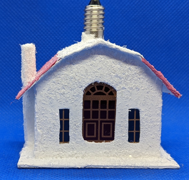

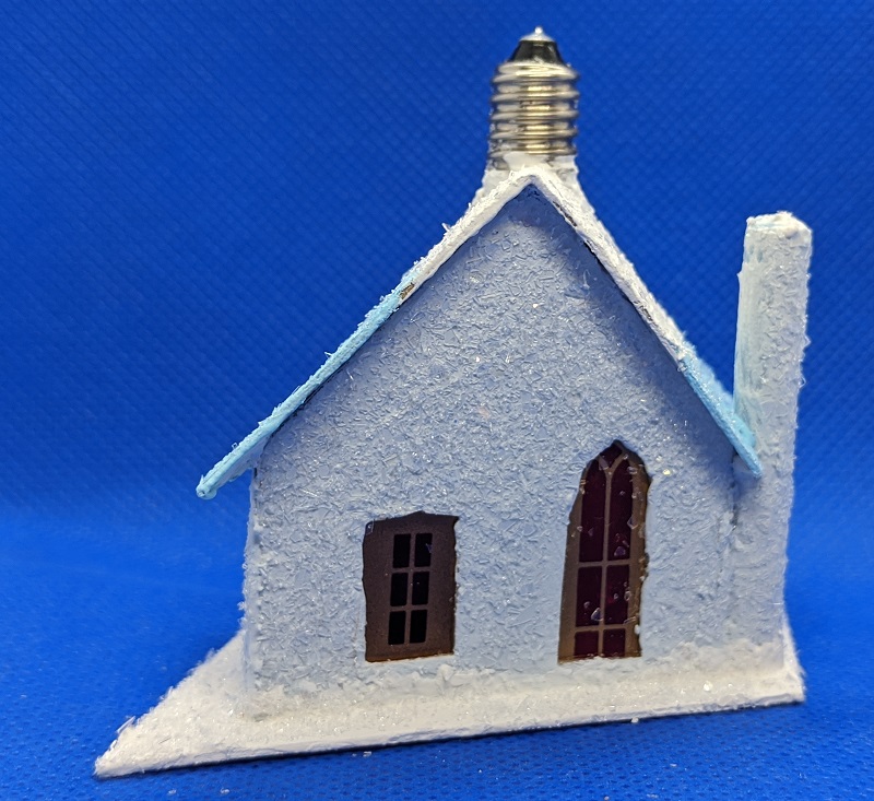

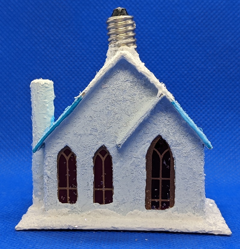

I got 2 more houses built. I need to make the last two.
- house 9.jpg (259.06 KiB) Viewed 20682 times
- house 5.jpg (220.48 KiB) Viewed 20682 times
The last two, I don't have a pattern for yet.
I need to sit down and lay them up.

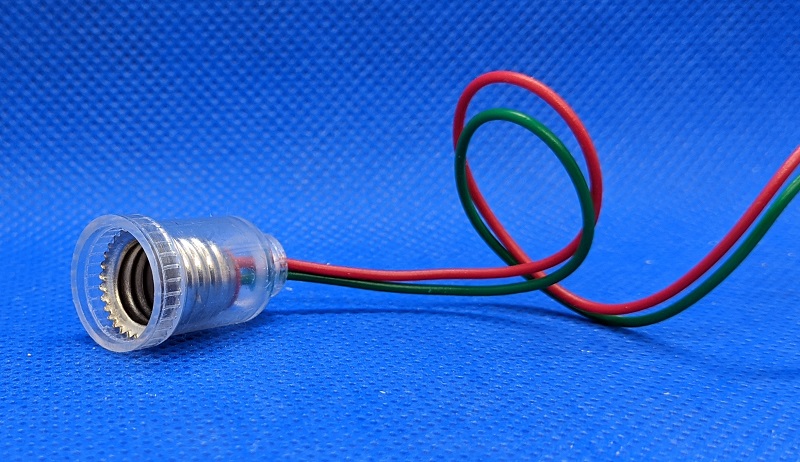

I started with the following E10 socket. As most know the E10 socket is what a C6 lamp screws into.
So starting with the E10 socket below:
- e10 socket.jpg (175.26 KiB) Viewed 20680 times

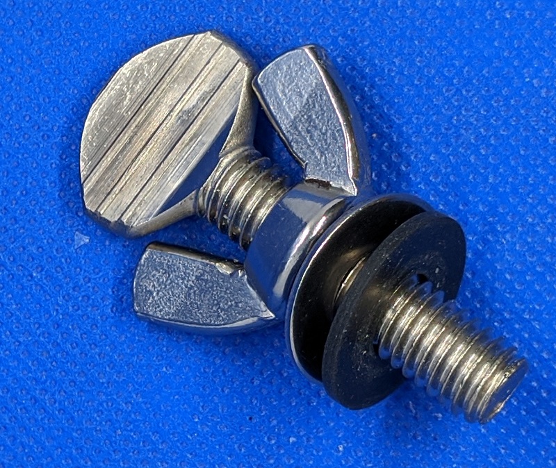

I needed a way to pull the socket out of the plastic housing.
For 2 reasons.
1 to be able to spray paint the housings black.
And I needed to wire them up in parallel, not series like the vintage version of the C6 light string.
I found a pretty cool way to pull the sockets out of the houses.
I can't remember where I first saw it.
It might have even been on another of Paul's Christmas related websites.
It's made of a 3/6" x 18 pitch bolt with a wing nut and a rubber and flat washer.
You screw the bolt into the socket, then turn the wing nut till the socket pops out.
- socket tool.jpg (274.27 KiB) Viewed 20680 times

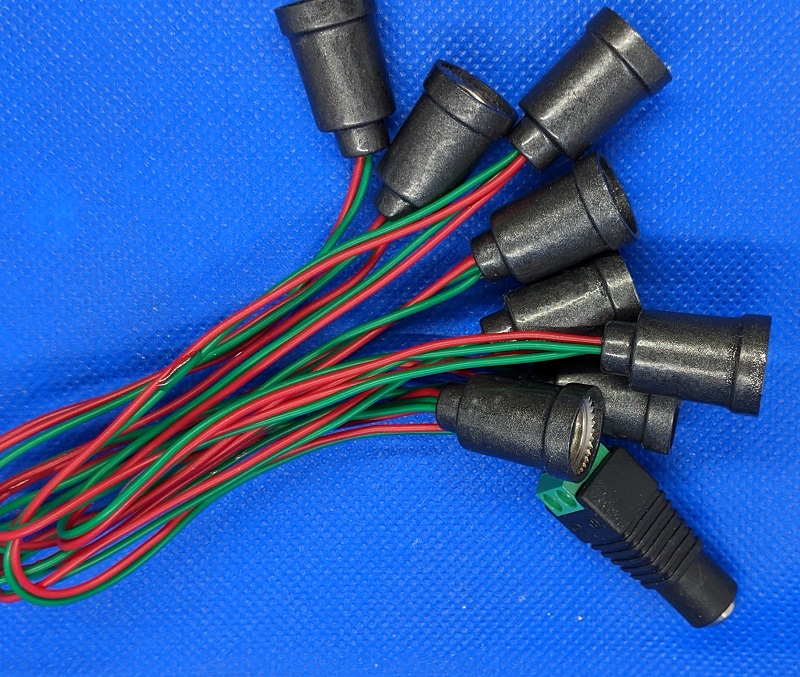

Once the sockets are removed. They were painted with some black paint.
then soldered together in a parallel string of 8 sockets.
- c6 string.jpg (305.53 KiB) Viewed 20680 times

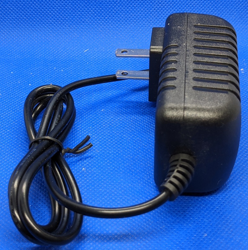

a 12 Vdc power supply finished it up.
- dc power supply.jpg (311.76 KiB) Viewed 20680 times

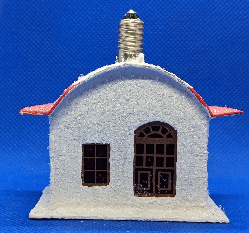

So, here's the last two houses.
- house 7.jpg (258.59 KiB) Viewed 20575 times
- house 8.jpg (280.57 KiB) Viewed 20575 times

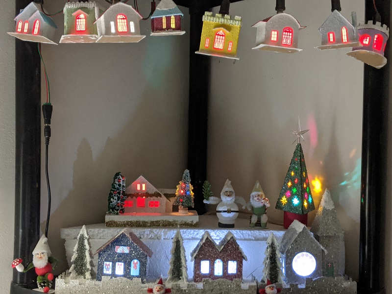

And here is all 8 hanging off of their light string.
All with my custom led bulbs that screw into the custom light string.
Also are a few more of my light-up decorations.
And lastly, I made some LEDs I can put in my Dolly repros.
I wish they showed up better when they photographed.
- all 8.jpg (198.35 KiB) Viewed 20575 times
