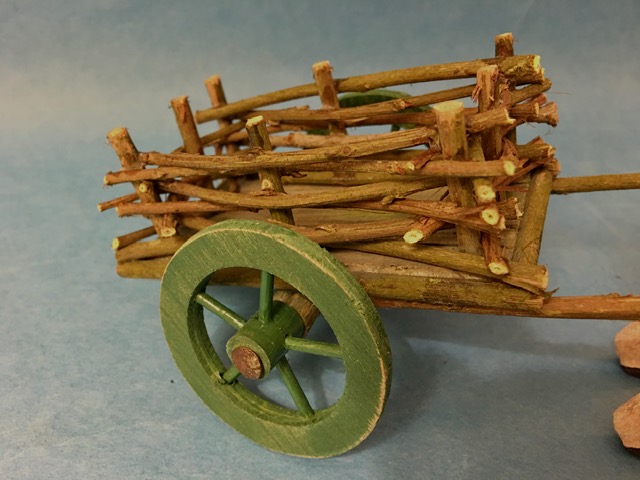

CART FLOOR…same plywood as rims…about the size of a business card…edged with crape myrtle twigs attached with super glue…the floor was stained and painted to mimic the colors of the twigs…
AXLE…3/8” diameter crape myrtle branch…rusty nails used to hold on wheels…
POSTS, WOVEN WATTLE SIDES and HARNESS ARMS…crape myrtle twigs…it’s easier to weave the wattle if the twigs are still green and not dried out…posts are super glued in holes in cart floor…super glue applied to the wattle weave joints after assembly…overall length of cart is about 7”…

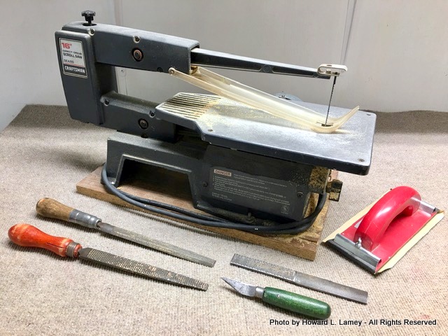

tools used to cut out, carve and shape wood body...scroll saw, rasps, bench knife and hand sander...tool not shown is a Dremel(R) rotary tool and round tip cutting burr...i'll add a picture of them to the next update...

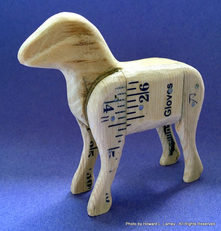

carved and shaped body...holes for ears not drilled in this photo...
closeup of ears...think of them as small wooden spoons...

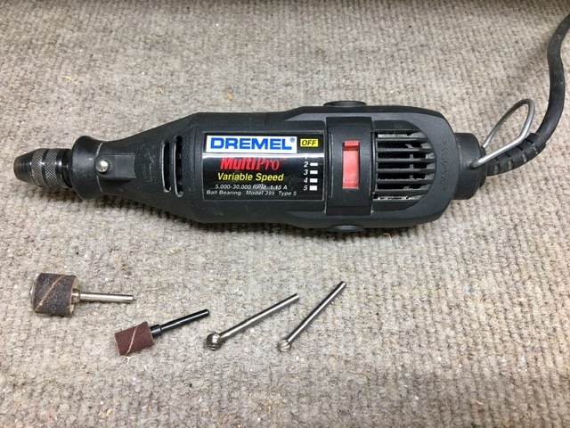

Dremel (R) tool plus sanding drums and round head cutting burs used on sheep...the burs were used for shaping the ears...

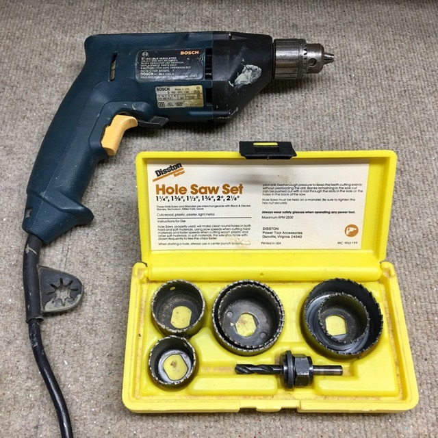

Hole saw and power drill used to cut out wheel rims...pix of wheel construction will be posted later...

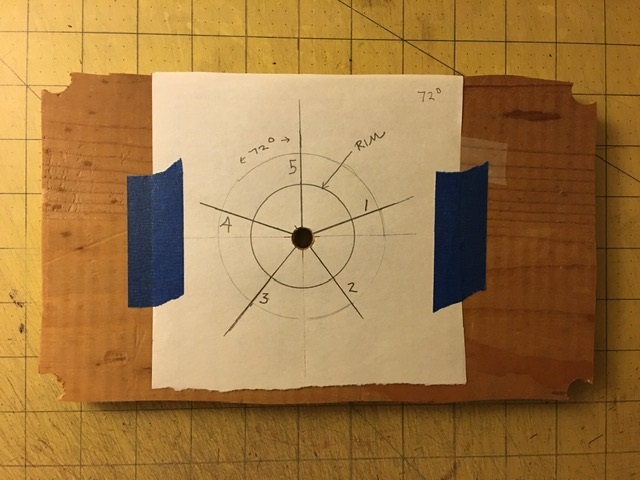

Here are pictures of the wheel parts, wheel jig and a wheel being assembled in the jig...Gorilla(R) super glue used for assembly...trim spokes flush with outside of rim when glue has dried...trim hub to length length and drill small hole for nail axle...
In addition to the five holes drilled through the edge of the rim, five shallow holes, about 1/8" or less, are also drilled in the 3/8" diameter hub...

- Post and wattle weave sides. Edges of wheel lightly sanded in a few places to "age" the look of the wheel and simulate wear.
