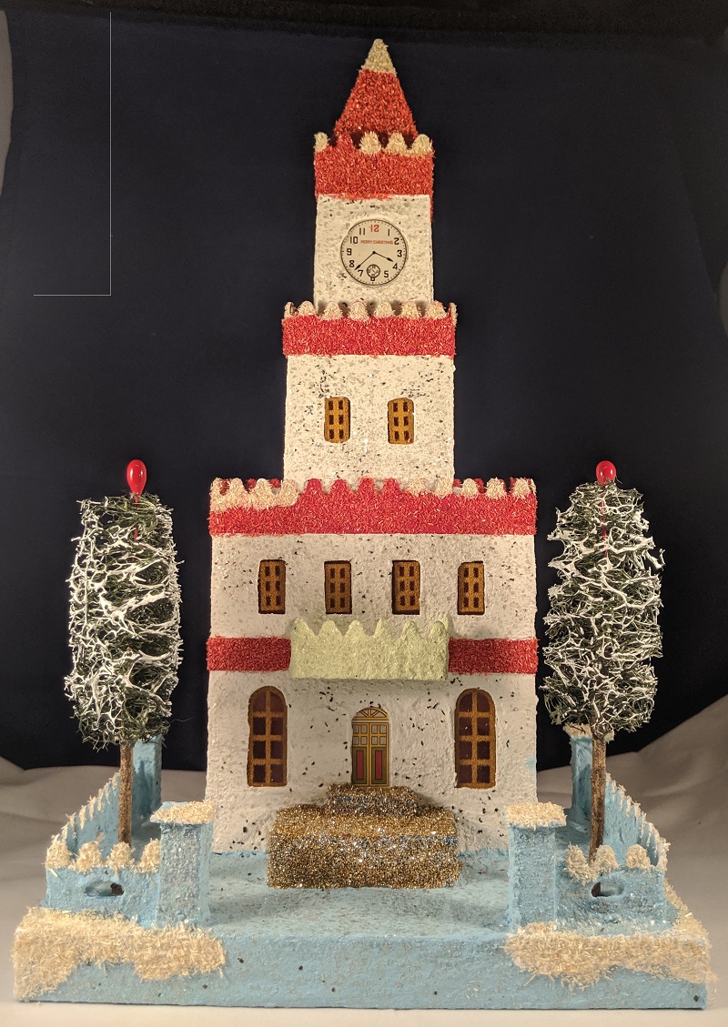

Ok. I spent way too much time on this one.
There's a bunch of things that I would have done differently if I made a second one.
I am using an experimental coating for white. I found If you get it oo wet it warps the cardboard.
I had to improvise a way to keep it from warping.
I was able to rescue a good share of it.
Of course, I see all the imperfections.
This the tallest house i've built to date. The flatiron and church repro are not as tall.
Thanks goes out to Peter for drawing up the pattern.
So without further ado, here it is:
high school 2.jpg (387.31 KiB) Viewed 24489 times
Now what to make next?

WOW Steve. I'm impressed! I have one built but I'm intimidated with the finishes. You did a great job, now I have the courage to finish mine. I started so experiments with the coating using flat cardboard, my stucco recipe, pigments and mica flakes. It's looking like you paint on the stucco and then sprinkle the mica on verses mixing the mica in the stucco. How did you do yours Steve? I fell bad I sent you the wrong small windows! I owe you. If I may ask what is you stucco recipe? Mine is Potter's Plaster, White Glue, Water and pigments. The consistency is critical. Keep up the outstanding workmanship.

steve...congratulations on a super building project!...it certainly does look vintage to me...every detail is just right...and yes...those large projects do take a lot of time to complete...but your end result has been worth every minute!...i for one am looking forward to pictures of your village this year!...

Steve - this is great! I agree with Howards comments about your work and I dont see any imperfections! Well done! Looking forward to see what you tackle next!

So my stucco recipe is nothing too special.
Not sure if you have ACE hardware in your part of the country.
But I start with ACE brand sheet rock patch in my case the Vinyl kind.
I start with that. I add a very small bit of water to thin it down.
I then add some floral sand to give it the sandy look you see on the original houses.
I then add the paint color I need to color it.
It is important to not get it too wet, That's how my cardboard started to warp when the
stucco got too wet.
Once on the house, I sprinkle some 90 grit black glitter.
Then sprinkle some mica on top of that.
Takes a bit to get used to using it, but you can see the results I got.
When I get home I'll find the exact vinyl patch compound I use.
