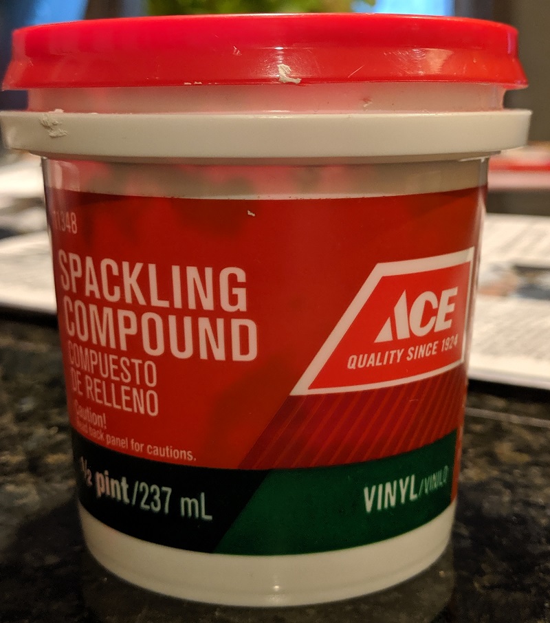

Just to follow up.
The spackling compound I used is pictured below:
spackling compound.jpg (204.95 KiB) Viewed 9333 times
Funny I can not find it on their website, but if I walk into the store it's right on the shelf.
So I start with that.
Add some floral sand to get it to the right texture you need.
It's easier if you use a vintage house as a reference.
Then the color you want it to be.
It will lighten as it dries.
I did add some water. Mind you I had a dropper bottle.
you don't need much. If too wet it with warp your cardboard.
But you want it wet enough so it flows.
I then sprinkle some 90 grit german glass glitter to give it the vintage black spots.
Then sprinkle finely ground mica over the top.
Let dry.
I experimented a bit to make it work.
Let dry.
