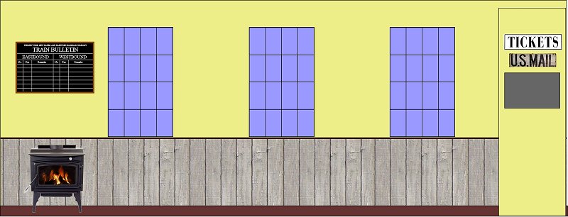

Here is a "mockup" I made of what I envisioned last spring.

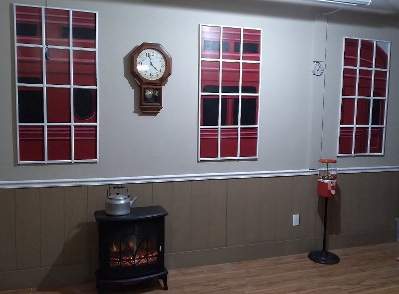

Here's the project so far (still missing the schedule board and the ticket booth)
Details of how much work it took and how I painted the windowframes start with this article: https://familygardentrains.com/newbost/ ... part_1.htm

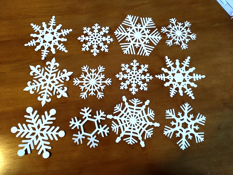

To be fair, I did get a bunch of snowflakes cut out for one of Shelia's crafts. The big ones are from the December 25 cartridge, which, unfortunately, is not supported by my Cricut Design Studio software, so I just have to dial in a size, punch a snowflake button and hope it works. The little ones are from an svg file I downloaded from the Internet, tweaked in Corel Draw, and cut with Sure cuts-a-Lot 2.

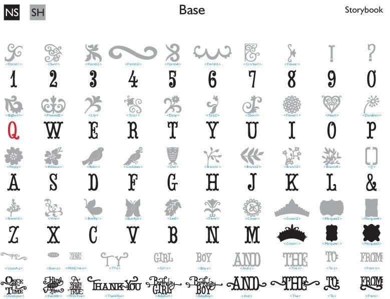

After determining that my December 25 cartridge ISN'T supported by Design Studio, I spent time making a list of the cartridges that are, in case I come across any more. Turns out that the cartridges I bought cheap at a WalMart closeout several years ago all are - Plantin Schoolbook, Designer's Calendar, Destinations, Stretch Your Imagination, and Storybook.
Though I have a wealth of "Old Western" fonts I could use for the railroad name on my timetable, I'm thinking of trying Storybook. Cricut's designers probably planned it to be a sort of "Once Upon a Time" font that would be surrounded by unicorns or such. But it's actually pretty close to a lot of the ornate wooden typefaces of the late 1800s.
I have bought enough white vinyl to print it out, and I have 1/4" white pinstriping tape coming in the mail. I've also painted the board that will be my timetable with Krylon Blackboard paint. So, we'll see. Here's the Storybook typeface if you are interested.

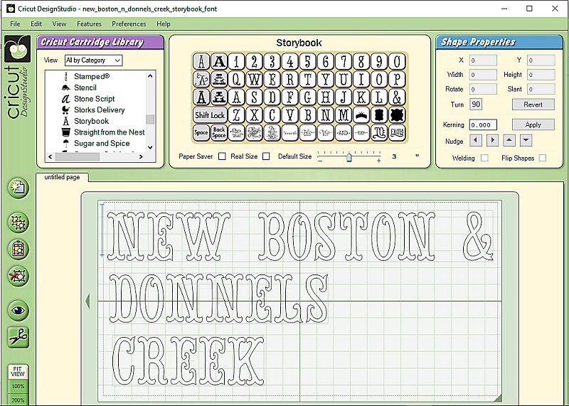

Here's the Cricut Design Studio screen with my title line for "New Boston and Donnels Creek" ready to cut.

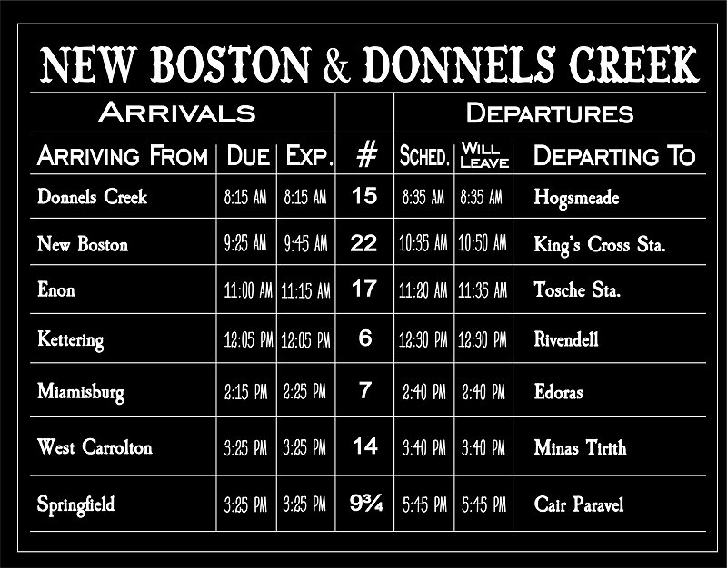

Here's a digital mockup of the timetable. I have painted a 48"x46" board with black chalkboard paint. The top three lines will be done with a craftcutter, and the rest will be done with chalk.
Whatcha think?
